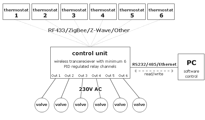

Hi, I hope on some help and product suggestions for my case. I have a central heating in my new apartment with radiators in each room. I want to smart control each room's temperature with smart thermostats or any other interface wirelessly (RF433/ZigBee/Z-wave/Other?) connected to a central control unit. I have mounted a Honeywell thermo valves in my collector box. They operate at 230V AC in normal close (NC) mode.
This is my collector box: What I need is wireless communicating thermostats or just interfaces (without thermostat logic built-in) and a central control unit with 6 or more 230V relay outputs. Also I need to communicate with my heating system somehow (RS232/RS485/Ethernet/ZigBee/Other?), so I could control it via software on Linux server (I can write this if I have the protocol specs).
I draw a sketch to illustrate how I see all this would happen: Could you suggest me some products for this case, that could be found in Europe and not be enormous pricey? I'm not afraid of making my hands dirty with building or modifying some hardware.
Also I would be happy to see other options and suggestions for best smart heating solution in that case.

Re: Wireless thermostats with central control unit
Mishobos,
most automating systems will be organized a little differently. The PC will receive information from sensors and will activate actors. This can both be done through different interfaces. A user control interface will also be directly connected to the PC that can control the actors (or show read out values of the sensors). This setup is far more suited for extension in the future.
So in short, I would replace the control unit in your diagram with the PC and have a user interface connected to that PC.
If you do it like this you can choose a hardware interface to the different items and do not have to look for very specific hardware that:
1 - has some sort of graphic UI usable for your application
2 - has wireless interfacing posibllities on its inputs
3 - has 230V ?A relay possibilities on its outputs.
Hope you understand what I am trying to say.
Mathijs
Hi, Tiz,
thank you for your answer. I have thought about that you said. It's really nice solution, but it misses some things again. This is how I see your suggestion:
1. Use some kind of control interfaces that communicate with a PC
2. Use some kind of wireless sensors that also communicate somehow with this PC
3. Use some kind of relay board attached to the PC with serial/USB/Ethernet
4. Software that takes data from the sensors and data from control interfaces and do PID math and controls the relay board
This is very challenging thig as I see it. All these hardware will speak different language that this software must understand and take some decisions. I don't know such a software.
The wall interfaces are another problem. The only thing that comes tomy mind is to use some tablets or Nokia N900 that communicate via http with the server. Other that comes to my mind is using some ZigBee buttons that send commands. Either ways I can't see this system to cost bellow 1500-2000$.

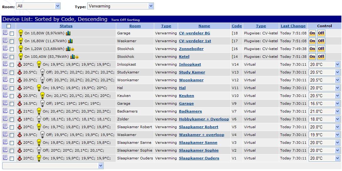

Hi Mishoboss,
What you are asking for is exactly what I have build on my house. I have 25 valves in my system which are operated by Normally closed servo motors. I use a PC with HomeSeer software as central contoller. The sevo motors are operated by ClickOnClickOff AC1000 220V switches. The temperature is monitored by Oregon Scientific sensors in every room. HomeSeer can receive and send with a RFXCOM receiver and transmitter. The script to control the heating is self written with scripting in HomeSeer.
I am still tuning the scripts and make a user interface in an Ipod so everybody in the house can control there own room temperature. So far I have focussed on keeping the temperatures constant at the selected setpoint. Regards,
Bart
Bart

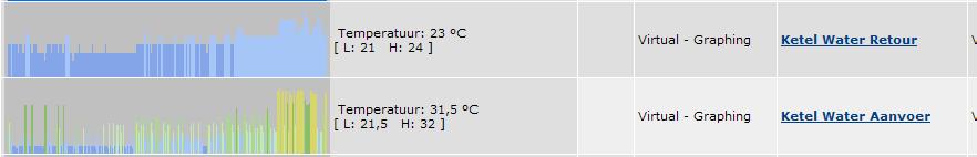

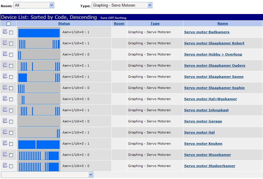

More pictures:
I created a virtual device to set the temperature for each room. The status includes:
- Requested temperature
- Status of servo motor
- current room temperature
- room temperature 30 min ago
- room temperature 60 min ago
- room temperature 90 min ago
- valve switching last 24 house
- servo motoren.JPG (93.02 KiB) Viewed 11093 times
