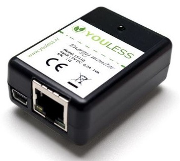

A new product from the Dutch market is the YouLess(.nl).
Not quite expensive because of the missing display instead of other products (mostly of the time on a non interesting frequency).
For a price of € 79,- you will receive the sensor (for both analog and slim-meters) and a usb and network cable.
I think the advantage is that the data update is every 60 seconds. Some other products have an update each 30 minutes.
I like to see 'realtime' data.
At this moment there is a desktop widget available and an ios app. Android will be soon available according the website.
They also working on a API, so a data interface to Homeseer should also be possible in the future.

This morning the YouLess was delivered finally.
It was send in a very small box which could be put thru the mailbox.
The youLess itself, a long usb cable with EU plug and a short utp cable is delivered. Also a simple but colorful 1 page manual for the basis steps.
At this moment I've an analog powermeter, and to get best input level (read: the highest light intensity for the sensor), I've to spend almost an half hour (for me 29 minutes too long..) to get it right.
What is the right input value? between 6 and 80% according the manual, in my case around 70% so I'm satisfied at this moment.
The input value drops around 40% when the little black stripe comes around because this color isn't reflective. This pulse is also visible in the realtime online config with a small black dot.
Now I've to check the YouLess counter with the counter of the analog powermeter the next days.
The get data from it, it's indeed via the UTP connection.
