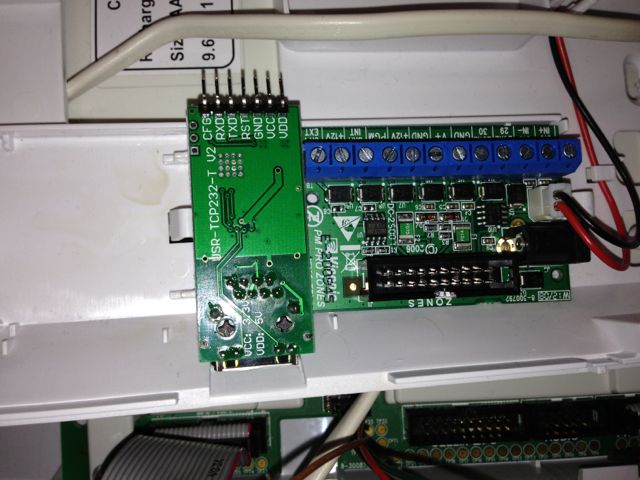

I ordered the same modules and used one to make my Powermax Pro ethernet enabled in minutes (see photo). A great feature is that the module support 4 simultaneous connections, which allowed me to connect from Homeseer using my plugin and a virtual com port driver and from linux using straight TCP/IP at the same time. Although my plugin was able to use the virtual com poort (with the free driver that came on the CD), the Visonic Remote Programmer does not recognize the COM port.
EDIT: The modules I ordered are not exactly the same as in mentioned in the previous post, I ordered these ones: http://en.usr.cn/RS232-serial-to-ethern ... -ip-module
- IMG_0067.jpg (59.36 KiB) Viewed 19252 times
- IMG_0069.jpg (32.48 KiB) Viewed 19252 times

I am up-ing this post as I am trying to do as René to connect my Visonic through Ethernet. I have a question (mainly to René I guess), as I am using the same USR-TCP232 device, is there a simple way to power the device from the Visonic? Of course I can go the 7805 route connected to the battery to reduce from 9.6V to 5V, but I suspect there should be 5V already somewhere on the board, maybe without even soldering (this to avoid voiding the warranty of my Powermax).
Thanks a lot in advance for any answer.
Rgds,
thefrip
Rgds,
thefrip
Re: Opentherm Gateway connected to the EZL-70 (IP)
You can hook it up directly to the 3.75V of the PowerMax. See this topic.
