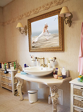

This solution is very nice but the price is also a bit high and have to be shipped and imported since they are made in the USA.
Also this solution of placing a mirror in front would be nice but starts somewhere for 65" tv at 1500 or 1700 usd
