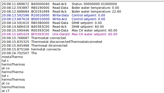

When connecting the on/off thermostat to the otgw all goes well when the thermostat sends an 'off' signal. However when the thermostat sends an 'on' signal the otgw monitor indicates thermostat was disconnected and afterwards only sends rubbish over the serial port.

Which version of the firmware are you using? I can somewhat reproduce this on firmware version 6.4 by creating contact chatter instead of having a solid contact. On firmware version 6.5 it no longer happens. So the first step is to upgrade to 6.5, if you're still running an older version of the firmware.
