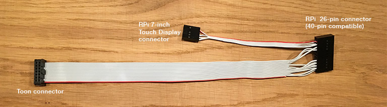

However, I should add that I made a cable that connects RPi's serial and JTAG to the Toon in one go (see attached picture). I can see why for most users it would be easier to be able to 'rescue' the Toon without having to connect JTAG as well.
Regards,
Marten
- Toon cable with description
- toon-cable-med.jpg (69.25 KiB) Viewed 38527 times
