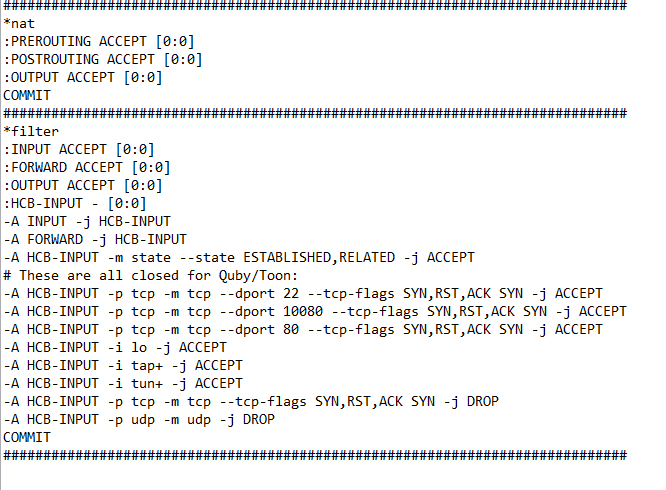

Got a 403 - Forbidden on http://%s/happ_thermstat?action=getThermostatInfo
iptable are ok:
TerrorSource
Posts: 494
Re: Controlling Toon via Domoticz
Post by TerrorSource »
mAiden wrote::x :x :x
iptable are ok:
As explained in the OP, i will not support the scripts or errors regarding the scripts. i did not create them
I will only support the manual itself.
iptable are ok:
Where do you receive this error?
On you web browser? when you go to your Toon : http://toonIP/happ_thermstat?action=getThermostatInfo
mAiden
Posts: 333
Post by mAiden »
iptable are ok:
Yes.
Domoticz give me this error on the log files.
Have try the fix for 403 forbidden, but can’t find the files hcb or qmf project

michel30 wrote:Hello,
Maybe this will help: domoticaforum.eu/viewtopic.php?f=87& ... 235#p82535
I have fixed already. Thanks for you're reply.
