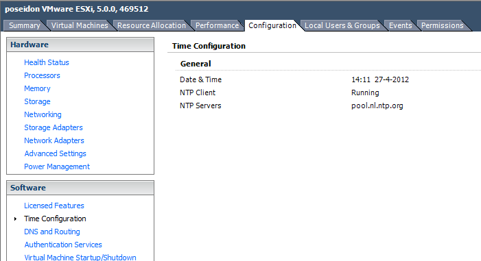

i've decided to use ESXi-V4 because it is 64b like V5 but i was not able to get the esxi host do a ntp time sync. In v4 it is a simple selection box which is disappeared in v5 esxi. A quick search on internet revealed that the option is removed in the free version but not in the full version so i stick to v4 for now.

I do have time sync in ESXi 5.0:
Did you grab this version? http://www.vmware.com/products/vsphere- ... rview.html

The iso i downloaded at march 27th this year was VMware-VMvisor-Installer-5.0.0-469512.x86_64 It seem's that this is the same version as your showing in your screenshot. From which period is your license, mine is from march 27th 2012.
