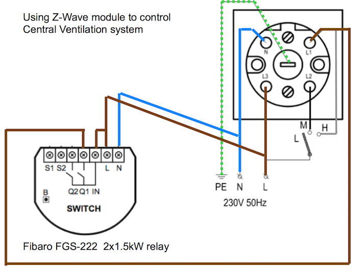

Moving away from X10 I would like to use a Z-Wave module to control my ventilation system.
Module: Fibaro FGS-222 (2x 1.5kW relay switch)
Schematics:
Connected: L3+... = low ventilation (always on)
Connected: L3+L2 = medium ventilation (don't care about this)
Connected: L3+L1 = high ventilation
- Output Q1 is used to add 'live' feed to L1 of the ventilation system.
- Now L3+L1 are connected resulting in high-ventilation
Q: Does this look right to you?
