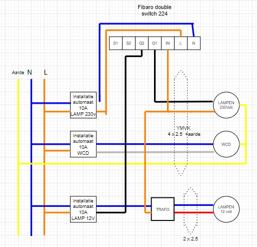

Hello there,
I am making a light plan for my new garden. I want to make use of my new Fibaro double switch 224. I have made a drawing about the connection with the electric wiring.
Can you look at the picture and give me a comment if the wiring is correct?
Thanks,
