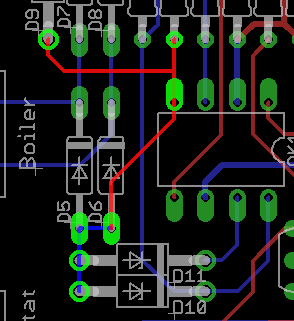

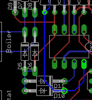

Now regarding your measurements: If you look at the schematic, the cathode of D10 is supposed to be connected to OK1 pin 8. If you find vastly different voltages at those two points, that apparently isn't the case. So please check the connections highlighted in the images below.
D10 -> OK1 pin 8
D10 -> OK1 pin 8
GND1
GND1

D10 -> OK1 pin 8
is connected
GND1
all are connected
I'll try to check all connections I can see on the pcb.
