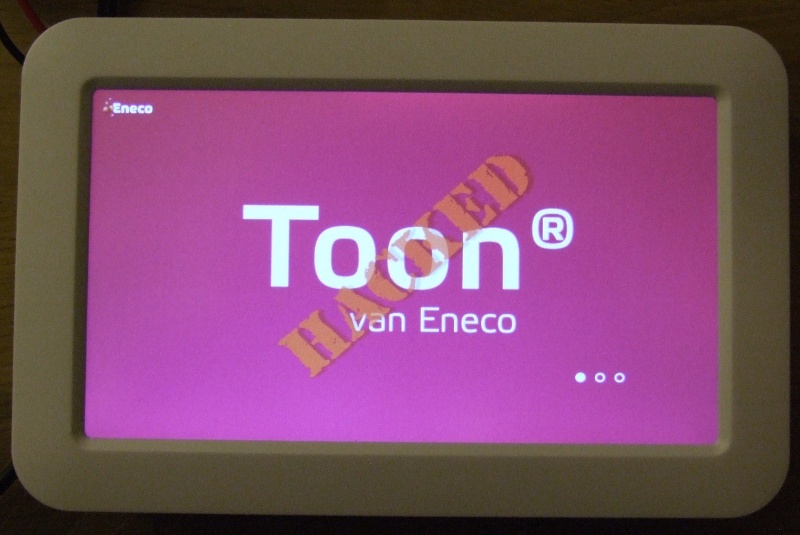

Turned out to be a no-brainer:
Just copy the ubifs settings from the quby oe tree to build the image and hey presto! A working ubifs root filesystem. Flashed onto /dev/mtd4 and now it's booting from ubifs.
Final step: flash a (modified) kernel onto /dev/mtd2 and reanimation of my toon is complete.
grtz,
Up and running again :-) :)
(well, on my kitchen table, not yet connected to the boiler).
grtz,
modified splash screen

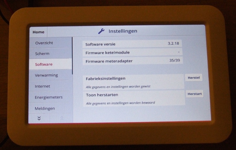

software page
software page
My toon runs FW 3.2.18, not sure if it has support for Toon met Zon
If you can just check the meter adapter firmware version, that's already something.
Mine has 35/39, and apparently that's the newest. For "toon met zon", I guess the number is different (but I'm not sure).
When "toon met zon" is activated, you should be able to add tiles related to solar energy production (quite a lot of them, actually).
BTW rooting hardware is just a few euros. Find a serial-to-usb adapter with 3.3V signal levels, and preferably with separate female header connectors for GND and TxD/RxD.

Nice work Marcel on resuscitating this Toon.
Posts: 2035
Good job on getting your Toon back to working order! In the end, did it take JTAG hardware, or were you able to do it with more common tools? In other words, if the same thing happened to my Toon, would I have a chance to restore it too? If so, it would be very nice if you could document what you had to do. No hurry, of course. Whenever you have time.
grtz,
Mine is also 35/39, so i reckon we have the same.
