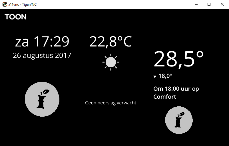

Posts: 1918
the old mod for the thermostat app did not look good on the newer firmware 4.x versions.
I made this small tweak to make it firmware 4 compatible. I can't put the temperature any higher without making much more invasive changes in the app.
No changes were needed for the Belgian icons, that is handled in the wastecollection app itself.
The attachment contains the full thermostat app for version 4.4.21 but only two files have been changed: ThermostatApp.qml and ThermostatSidepanel.qml.
All code changes are marked between the lines 'waste display start' and 'waste display end'.
Note: the icon will show only 6 minutes after restart of the gui and will be updated daily at 18.01 to show the icon for the next day
Summarizing:
- use the earlier posted version 1.2 of the mod for firmware version 3.7.9 (manually apply to other 3.x versions)
- use this version 1.3 on firmware 4.4.21 (manually apply to other 4.x versions)
both are compatible with any recent version of the wastecollection app.
The screenshot below shows the icon twice: once on the tile (which you don't need with this mod) and one via the thermostat mod.
Kind regardz,
wastecollection_thermostat_mod_v1.3_(fw4.4.21).zip
(163.69 KiB) Downloaded 570 times
