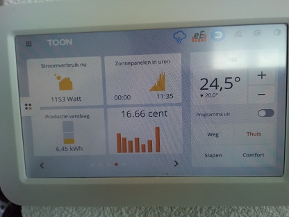

I have a very alpha version running. Only showing the current tariff which is updated every hour from the easyenergy website. And still need to works on the graphics. But it works.. it's something :D

Toon EasyEnergy alpha version

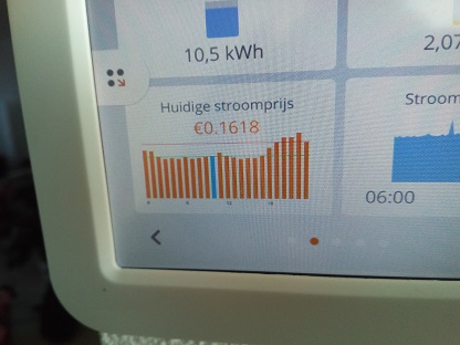

Showing the current tariff is now ready. See photo.
Two horizontal lines show when the tariffs are good, normal or bad, based on the quartile values of the whole day. The tariff text color will change according to this (green, orangje or red).
The code is far from complete. Still need a lot of santizing. But it works and I can share it. Better to create a new topic from now I guess?
