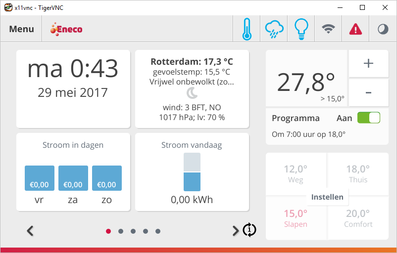

the issues with my previous attempt to rotate tiles have been resolved.
The following homescreen mod gives you the ability to automatically rotate tiles on the first page of the homescreens in 4 ways:
0: no rotation, behaviour as normal
1: rotate only the right bottom tile and leave the other three untouched (both normal and dim state)
2: rotate the bottom two tiles and leave the upper two untouched (both normal and dim state)
3: rotate the whole homescreen. In this case no tile configuration is changed, merely the next homepage is selected every x seconds (only in dim state)
You can change the behaviour 'on the fly' by clicking on the new icon just right of the '>' page selector at the bottom.
The small number in the icon represent the rotation mode above.
Default value is 0 (no rotation).
