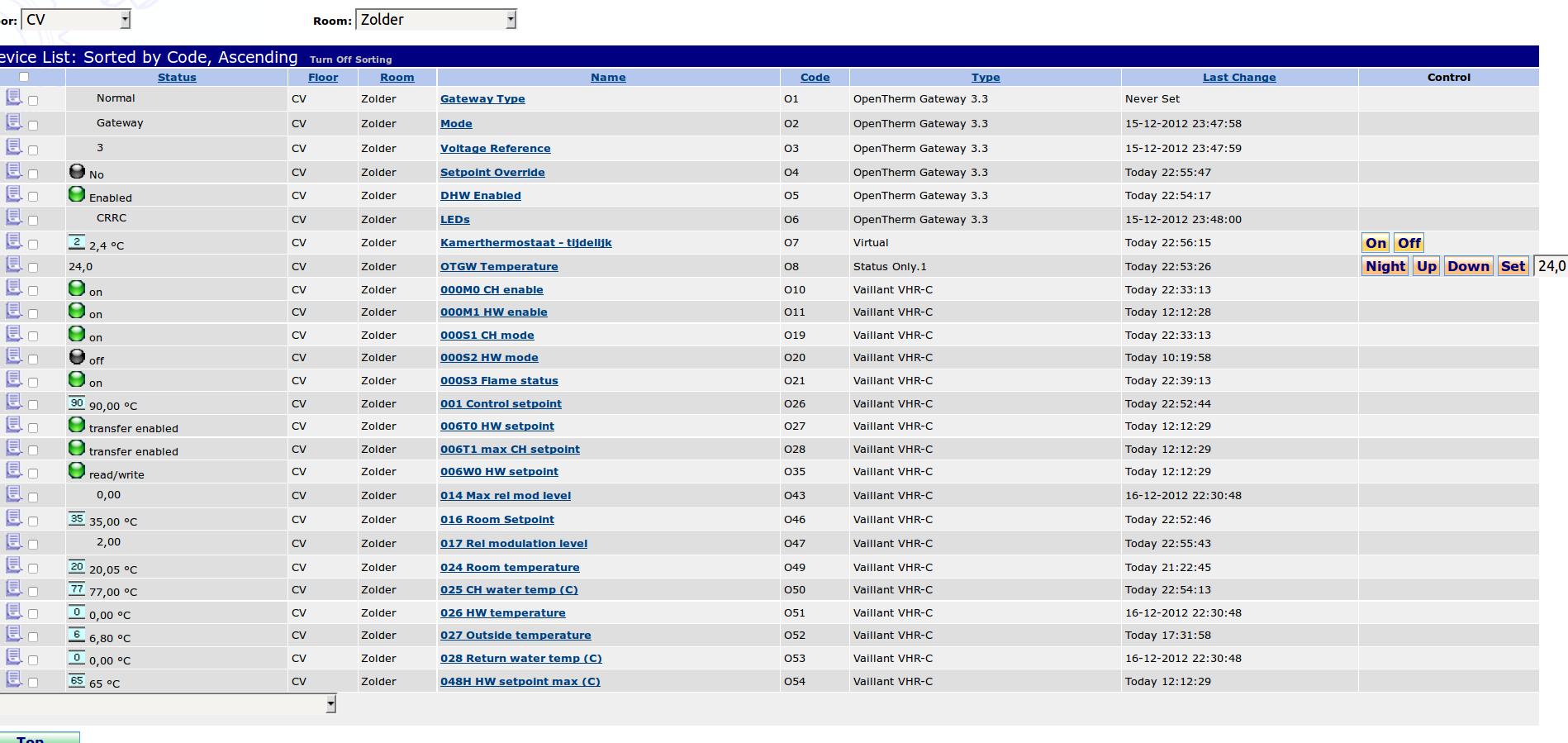

Tonight i bought myself another thermostat (Honeywell Round Modulation) and now the gateway is working as designed (the previous thermostat did not had a setpoint to set)
Now the only problem left is that i`m unable to use the "virtual device" which should be created as a droplist device. The device is there but the droplist is not. I`m now forced to set the Day and Night temp using two scripts. However this is working i want to be able to set the temp in steps of 0.5 degrees

I don't have this dropdown list eighter, so I created a second script who creates one extra virtual device with extra control buttons and this dropdown list.
An advantage at the moment for me is that the buttons can be used in Hstouch also. With 'Set' you activate the definitly temperature. Probably also possible via an other way.....
The script copy the value at the moment to the temporary 'Kamerthermostaat' device. If this script works fine, one of the devices could be deleted.

How did you create this device. Using the HomeSeer interface i`m able to create a virtual device but thats all.
When you look at post 1 of this topic it seems that Rutger has something to do with the expension of the 7th virtual device. I think thats you :mrgreen: Please tell us more
I`m no script guru but i think there is an issue with the original script. Or maybe i just don`t understand how al variables are set for the creation of the device

I have tried the "new" script and get the device i expected. However i do not have the OT_XX_Device_Control.vb script.
This is my current device creation script

Tonight i made some time to take another shot on my thermostat
I have created an event which runs the following script once to create the device (OT_O8_Device_Control.vb)
Sub Main(ByVal Parms As String)
' Created by    : Rutger Bockholts
' Version       : 1.0
' Date      : 15-12-2012
' This script will create a virtual device, status only, and add the control buttons Up, Down, Set, Night, and a dropdown list with degrees.
' Usable with "BLB_OT_monitor_02.vb" script for the OpenTherm Gateway
' DeviceTherm "H7" is the device "Kamerthermostaat-Tijdelijk" which is created by the "BLB_OT_monitor_02.vb" script.
' DeviceCode "H9" is the virtual device in this script.

But this will result in a issues with the gateway because of a setpoint of 2.4 when is should be 24 degrees (I`m not a HS / VB expert but already changed the dot with a comma in the script but this does not help) When something goes wrong during setting of the temperature the gateway or thermostat wil go into the max temp mode (35 degrees) which is hot
