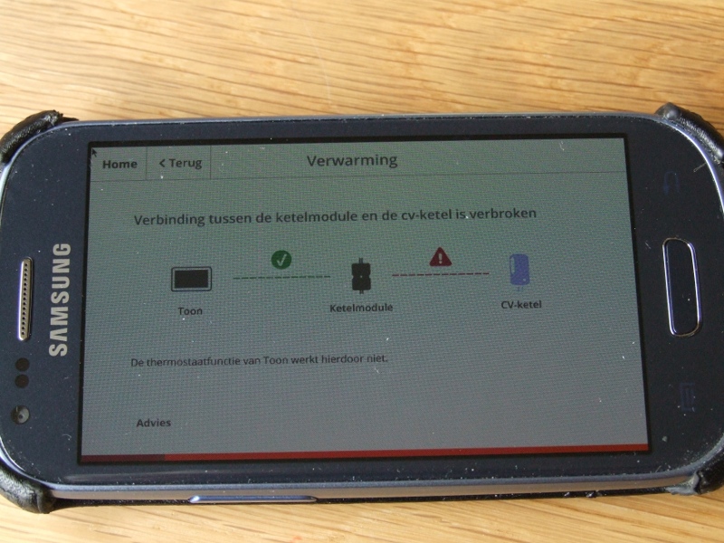

Works, see attached images.
With x11vnc for toon and TigerVNC as client on my linux box, at least.
It also works on my (ancient) phone (android 2.something). I think we have our own version of "Toon op Afstand" within reach
Need to clean up the start-up script, shrink the x11vnc server a little, figure out password handling, make the server persistent, write a short manual and then we're good to go.

- toon_remote_control.jpg (214.37 KiB) Viewed 18787 times
- root_window_1280x720.jpg (242.83 KiB) Viewed 18788 times

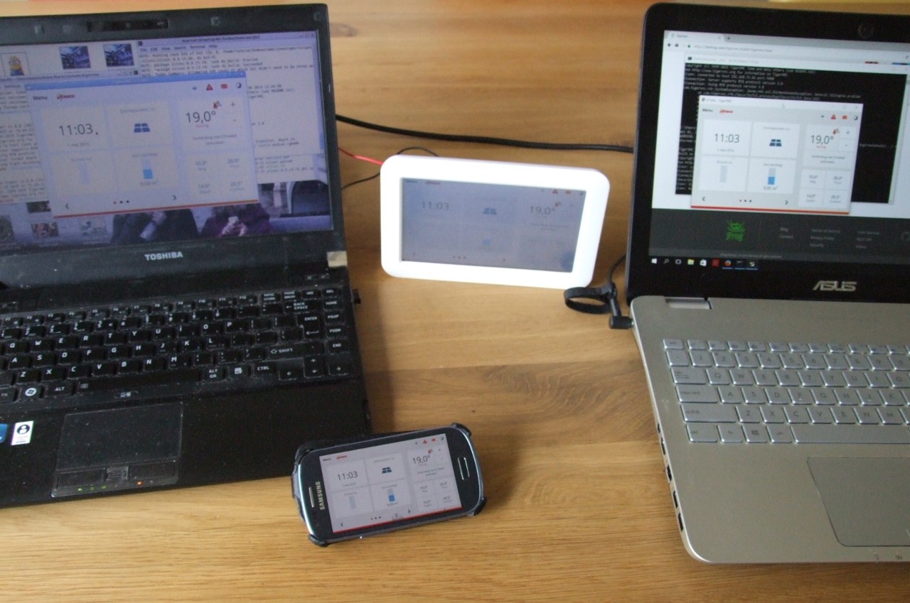

The first release of x11vnc for toon is now available
Download the package, and follow the manual:
edit 20160601: download files moved to downloads thread.
Below is a picture of my test toon, forwarding its screen to a linux, a windows, and an android device
Enjoy.
grtz,

- Toon's VNC on linux, windows and android, simultaneously.
- x11vnc_sc.jpg (211.65 KiB) Viewed 18512 times
