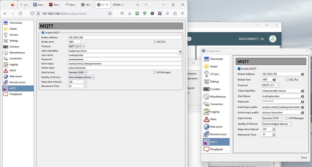

On the MQTT explorer I can see that boilerwatertemperature is being transmitted but doesn't change. If I use the Windows version of OTGW it all works fine so I assume it is a bug in the Raspberry Pi version.

There are no such bug in armf or aarch64 version of otmotitor, all versions use the same tcl code. Only runtime is different.
Please compare you configuration for windows and raspi.
boilerwatertemperature shouldn't be retained, please check. Try to remove the whole tree of event/# topic from MQTT Explorer.

On further investigation of this I can see that with the windows desktop version everything works fine. On the RaspberryPi version, the boiler water temperature is transmitted once via MQTT, then never transmitted again. I have double checked the MQTT settings in both instances and they are identical.

I think the value of boilerwatertemperature is retained in your case, I have no idea why. Which mqtt broker are in use?

I have tried two different MQTT brokers, Mosquitto and HiveMQ. The results are the same.

Please describe how do you run otmonitor on rpi, command line, content of configuration file.

I followed the instructions at https://otgw.tclcode.com/raspi.html to run headless set up. OTmonitor starts automatically on reboot.

OK, lets continue without details of configuration...
Assume you are using mosquitto ...
please run mosquitto_sub on the same rpi on which you are running otmonitor:
mosquitto_sub -h <broker ip> -p <broker port> -u <username> --pw <password> -t events/#
<broker ip> <broker port> must be the same as for otmonitor (that is the reason why I asked for a content of config file)
Log from the broker also will be usefull..

Does this help?
Sorry I wasn't sure what config file you were referring to
2023-01-22 3.jpg (112.95 KiB) Viewed 6822 times
This screen shot shows the MQTT set up for Windows version of Otmonitor (right) and RPI (left). From the mosquitto_sub, I can see that boilerwatertemperature is transmitted to MQTT as expected when running windows version, but when running RPI version although I can see the boilerwatertemperature change on the messages in otmonitor, it never gets transmitted after the initial transmission to MQTT.
