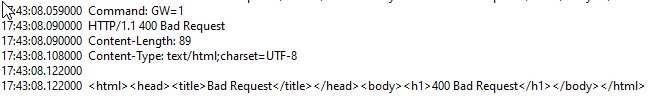

Doesn't work for me (with the web server on port 80)
None of the three proposed codes, entered via the Miscellaneous tab, work properly. Each time the command GW=1 gives the following response:
HTTP/1.1 400 Bad Request
For example:
Scherm­afbeelding 2024-01-01 om 17.43.26.jpg (18.85 KiB) Viewed 2905 times

Ah, so it's not OTmonitor that gives the answer "HTTP/1.1 400 Bad Request". OTmonitor only reports that whatever it is connected to produced "HTTP/1.1 400 Bad Request". So it seems that you are not connected to the serial data port of the OTGW.
From a previous post I understand you have an OTGW with a Wemos module running the OTGW-firmware by rvdbreemen. With that configuration you need to connect OTmonitor to port 25238 at the IP address of the Wemos. My guess is you connected to port 80 instead.
