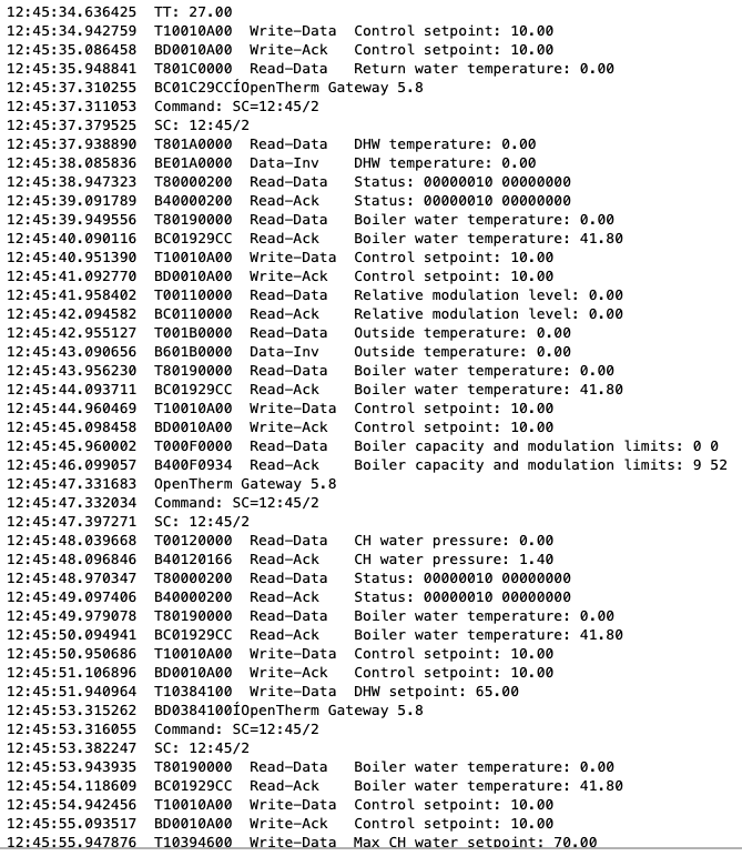

Thanks for the reply! Sorry i wasnt't able to reply earlier. I've been trying it again today and both on our heatpump and our boiler (remeha calenta 28c) it does not appear to react to commands. I've also orderd a new pic which should be in today. Screenshot of log of otmonitor added below.
Screenshot 2025-07-15 at 12.46.07.png (194.16 KiB) Viewed 103 times

See point #5 on the Creating an effective incident report topic for how to make a useful log. A screen shot is usually not very helpful. Although in your case the screenshot does show that the PIC resets every couple of seconds. This explains why the TT command has no effect: The PIC restarts before it gets a chance to send a setpoint override to the thermostat. TT and TC commands are not preserved across a reset.
The next question is of course: Why does the PIC reset? Use the PR=Q command to find out. Is your power supply stable and does it provide a high enough voltage?
