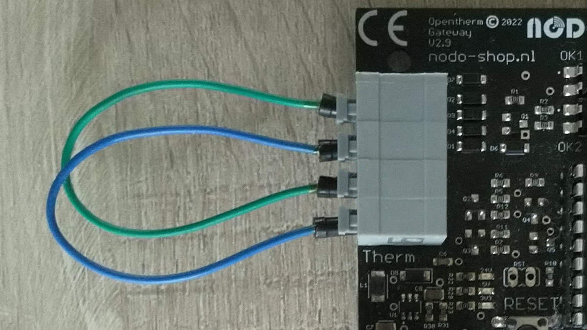

Test #4: Delay symmetry
Error: Interfaces don't appear to be looped

Aboreon wrote: Wed Jul 16, 2025 9:20 pm Test #4: Delay symmetry
This indicates a hardware fault of the OTGW or a bad connection, assuming you followed the test instructions and looped the OTGW thermostat terminals to the boiler terminals as shown in the picture below.
Make sure you properly soldered the connector onto the PCB.
