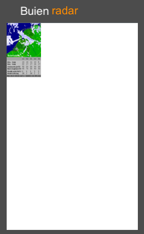

Buienradar on my iPad is not showing correctly
URL used: http://gratisweerdata.buienradar.nl/buienradar.php
This works fine in the designer, safari but on the iPad the map is VERY small, surrounded by white space.
Buienradar probleem iPad
Has anyone used this buienradar data on their iPad?
Thank you

If you use a different URL, you can get a bigger image from buienrader. For example:
http://www2.buienradar.nl/display.php?w ... opacity=75
Note: unless you tell it otherwise, Safari iPhone (and iPad) assumes your page is 980px wide.
You can also change this behaviour by adding a meta tag to your html-header. For example this one:
<meta name="viewport" content="user-scalable=no, width=device-width" />

Thank you very much.. It's working now.
It has been a long time since I worked on OSX/Safari based browsers ;-)
Now the following source also works, providing that you point to this HTML file you have to host somewhere:
<meta http-equiv="refresh" content="300" />
<meta name="viewport" content="user-scalable=no, width=300" />
<html> <IFRAME SRC="http://gratisweerdata.buienradar.nl/buienradar.php" NORESIZE SCROLLING=NO HSPACE=0 VSPACE=0 FRAMEBORDER=0 MARGINHEIGHT=0 MARGINWIDTH=0 WIDTH=256 HEIGHT=406></IFRAME> </html>
You probably have to tweak back-ground colors and sizes, but it gives you some extra information.
