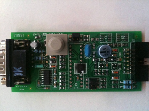

Not really hires but pictures taken by my iPhone. Please have a look and tell me if it's worth to make better shots. It's hard to see which pins are connected. The NULL modem cable must provide the PC side pin 4 to Quinta side pins 1 and 6. Without it it doesn't work. The software reset doesn't actually reset the Quinta just it doesn't with the Avanta. Too bad, but I have found a way to determine if the Quinta has an error AND stopped working because of it.

Thx Richard for the info.
Via the pictures from Richard we found out there was a MX2xx ic in there, which of course takes care of the RS232 line driving.
The other chip was a LPC764BDH from Philips. This is a small microcontroller with i2c on it as well. So the mini GMI interface indeed takes care of i2c to RS232 conversion.
This makes it pretty complicated as we don´t know how the microcontroller communicates to the main controller of the kettle. We know it is i2c, but that is all..... In theory we could get a JeeNode to communicate with the kettle, if we just knew how they communicated....
Guess I´ll go and buy a cable this week.....;-)

Re: Remeha Calenta interface for Homeseer
Agree will be difficult, I also think better to buy!
Here are the pictures (full resolution)
