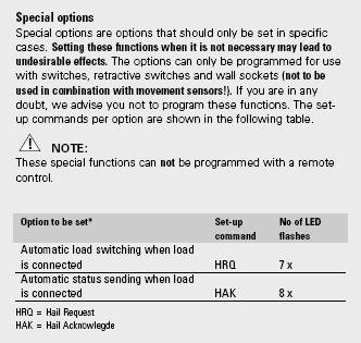

Just to be sure though, in the manual i see these two options:
"Automatic load switching when load is enabled"
"Automatic status sending when load is connected"
Do i only need to program the second function? and if so how do i send HAK (hail acknowledge) requests from homeseer to program it?

I have read that part of the manual, but do not know if i need to set one, both or none of those functions (since some stated that xanura is 2 way by default).
And if i have to set those i have no idea how to send HAK or HRQ commands. Should i do that trough the Control tab and use some script commands to send the HAK or HRQ?

I think you need to set the HAK
This can be done with the pmix35
i also think it can be done with a Homeseer script
sample is on this forum, but dont know where exact

I found a topic explaining the script: http://www.domoticaforum.eu/viewtopic.php?f=26&t=888
I tried setting the HAK but it still will not respond to hail requests.
