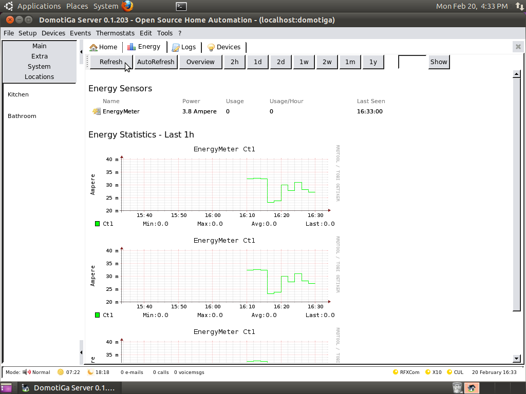

After creating and deleting a lot of graphs, all I can get is m as units (Y axle). Not Amps or Watts . I'm using advanced graphs (with simple graphs the result is the same). Also, in Graph Data, the Operation field does not change the result (I've read almost all posts on this forum regarding graphs in Domotiga and did not found a solution).

Did you get any further yet? If not canyou mail a screenshot to see whats the problem?

Here is an example:

Are you sure you set the data-source type of the device(s) to "GAUGE" on the graph tab of the device(s)?
I have seen these milli notations before when a wrong data-source type was selected.
Regards, Ron.

Thanks, changing to Gauge resolved the issue.
