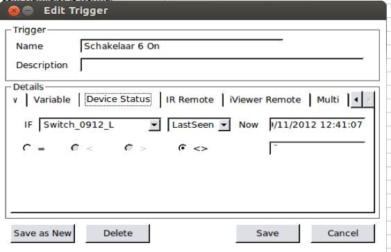

Because of a reason I still not figured out why sometimes commands do not reach the devices, I want to be able to resend the command once more when I push the button on my KAKU AWST-8802 device.
At this moment I have 3 Greewave powernode's that I use for measuring and powering down / on devices. for example I have one powernode on my work desk and on there my scanner, printer, videoconference unit and scan server is connected. this equipment is about 80 watt. When I am not home or behind my desk this equipment needs to be off. But I want to have a switch nearby to turn everything on. I replaced a normal single light switch with a double kaku switch. on for the lights and the other for turning on the equipment on my desk.
At this moment it seems like that domotiga is not always able to send the "on" commands to the zwave devices. I can see in the logs that the commands from kaku reach domotiga all the time.
I now have a event with a trigger (device status, if "device" = On) and the a couple of action to turn the device's. but if the the kaku status is already "on" this event is not going to triggered.
Can someone help me creating a event with the right triggers that always send a "on" command.

You'll need to program a trigger on basis of device status(like you probably already do) on the "Edit Trigger" screen:
if [deviceNAME][LastSeen] <> " "
you choose [deviceNAME] and [LastSeen] from the list.
After this you can have domotiga execute everytime you push the on button.

doesn't seem to work that way. when I create a trigger lik this:
Screen Shot 2012-09-11 at 12.40.10 PM.png (53.15 KiB) Viewed 8367 times
My equipment goes on and off directly in seconds.
see debug below:

j.hoekstra
Posts: 255
Re: How to send a "On" command even if the trigger device is On
Post by j.hoekstra »
Sorry, the "" needs to have a space inbetween like " ".

The Trigger works if I look at the output, however you still need to check if the status of the device you trigger with is "On" or "Off". I'm guessing you have 2 events for the triggering device, switching on and off and both get triggered.

Yes that is true, I have two events 1 for one for "On" and one for "Off". If I disable my "Off" event your methode is working perfect. I don't know exactly how the "Off" event is triggered. Any idee's how I can do the check before?

An event is build up with a trigger which starts the eveluation of the event, a condition where the status of the triggering device and possibly other conditions are check(only execute when dark for instance) and then the action which sets a device to a certain state.
In "Condition(s)" you need to define that the state of the device is "On" or "Off", if you do that you can both switch on and off.

thank you. I reconfigured all my switches and this is working perfectly. I also understand the "lastseen" option now.
