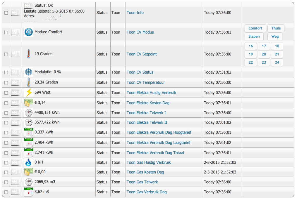

Hi ,
I added the function to readout the historical data for gas and elektro, it generates 2 tekstfiles for now. I haveing trouble to understand whats being send in JSON and interpret this. What would you like to do with this info.
btw since the last toon update a lot more data is available from the toon, i will also look into that.
bart

Hi Bart,
I'm willing to help to rewrite the toon plugin and make a better integration with Homeseer (root/child device, HSTouch thermostat compatibility etc.). Can you send me your latest version, so I can use that as base for my rewrite?
ps. As Homeseer 3.0.0.152 has been released, you can release your latest version.
Regards,
Erwin
bartbakels
Posts: 515
Re: Eneco Toon Homeseer Script/Plugin
Post by bartbakels »
Erwin,
Great to hear that, hereby the latest version. I was just thinking about rewriting the script. Let me know if u need additional help. I know that there are some issues with this version regarding the gas usage, didn't had the time to debug
Imports system.io
Sub Main(params as object)
	'Control Eneco Toon Thermostat For Homeseer3 v1.2
	'Made by Bart Bakels/ Promedes.nl

			If Debug > 1 Then
				hs.WriteLog("Toon SP written","SP set to: " & setpoint & "  response: " & spsetresponse)
				hs.WriteLog("Toon SP written","SP set to: " & setpointraw)
			End If
			indexstart = InStr(spsetresponse, """success"": true")
			If indexstart = 0 Then
				hs.WriteLog("Toon Error", "Could Not change Setpoint")
			End If
		End If
	End If ' errorcheck
	'Write Mode to Toon
	If errorflag = 0 Then 'errorcheck
		If Not selectedMode = "" Then
			modesetresponse = hs.URLAction("https://toonopafstand.eneco.nl/toonMobileBackendWeb/client/auth/schemeState?clientId=" & clientid & "&clientIdChecksum=" & clientidchecksum & "&state=2&temperatureState=" & selectedMode & "&random=" & random,"GET", "", "")
			If Debug > 1 Then
				hs.WriteLog("Toon Mode written","Mode set to: " & selectedMode & "  response: " & modesetresponse)
			End If
			indexstart = InStr(modesetresponse, """success"": true")
				hs.WriteLog("Toon Error", "Could Not change Toon Mode")
			End If
		End If
	End If ' errorcheck
	'Retrieve Toon State 1
		state1response = hs.URLAction("https://toonopafstand.eneco.nl/toonMobileBackendWeb/client/auth/retrieveToonState?clientId=" & clientid & "&clientIdChecksum=" & clientidchecksum & "&random=" & random,"GET", "", "")
		If Debug = 2 Then
			hs.WriteLog("Toon response status 1 ", state1response)
		End If
	End If ' errorcheck
	'Retrieve Toon State 2
		state2response = hs.URLAction("https://toonopafstand.eneco.nl/toonMobileBackendWeb/client/auth/retrieveToonState?clientId=" & clientid & "&clientIdChecksum=" & clientidchecksum & "&random=" & random,"GET", "", "")
		If Debug = 2 Then
			hs.WriteLog("Toon response status 2 ", state2response)
		End If
	End If ' errorcheck
	'Retrieve Toon State 3 DISABLED
		'state3response = hs.URLAction("https://toonopafstand.eneco.nl/toonMobileBackendWeb/client/auth/retrieveToonState?clientId=" & clientid & "&clientIdChecksum=" & clientidchecksum & "&random=" & random,"GET", "", "")
		'If Debug = 2 Then
		'hs.WriteLog("Toon response status 3 ", state3response)
		'End If
		stateresponse = state3response & state2response & state1response
		fso = CreateObject("Scripting.FileSystemObject")
		f = fso.OpenTextFile("c:\temp\ToonState.txt", ForWriting, True)
		f.writeline (stateresponse)
		If Debug = 2 Then
			hs.WriteLog("Toon response TOTAL ", stateresponse)
		End If
	End If ' errorcheck
	'Get GAS and Electro Historical DATA
	if gethistoricaldata = "UPDATE" then
	'Get Electro historical data
		edataresponse = hs.URLAction("https://toonopafstand.eneco.nl/toonMobileBackendWeb/client/auth/getElecGraphData?clientId=" & clientid & "&clientIdChecksum=" & clientidchecksum,"GET", "", "")
		f = fso.OpenTextFile("c:\temp\ToonElectroData.txt", ForWriting, True)
		f.writeline (edataresponse)
		If Debug = 2 Then
			hs.WriteLog("historical E data response", edataresponse)
		End If
	'Get Gas historical data
		gdataresponse = hs.URLAction("https://toonopafstand.eneco.nl/toonMobileBackendWeb/client/auth/getGasGraphData?clientId=" & clientid & "&clientIdChecksum=" & clientidchecksum,"GET", "", "")
		f = fso.OpenTextFile("c:\temp\ToonGasData.txt", ForWriting, True)
		f.writeline (gdataresponse)
		If Debug = 2 Then
			hs.WriteLog("historical G data response", gdataresponse)
		End If
	End If 'check historical data
	End If ' errorcheck
	'Logout
		logoutresponse = hs.URLAction("https://toonopafstand.eneco.nl/toonMobileBackendWeb/client/auth/logout?clientId=" & clientid & "&clientIdChecksum=" & clientidchecksum & "&random=" & random,"GET", "", "")
		If Debug = 2 Then
			hs.WriteLog("Toon response logout", logoutresponse)
		End If
		indexstart = InStr(logoutresponse, "success")
			hs.WriteLog("Toon Error", "Could Not Logout")
			errorflag = 1
		End If
	End If ' errorcheck
	'decode state
		'Current temperature
		Dim currenttemp
		indexstart = InStr(stateresponse," ""currentTemp"": ")
		If indexstart >  1 Then
			indexend = InStr(indexstart,stateresponse,",")
			indexstart = indexstart + 16
			indexend = indexend-indexstart
			currenttemp = Mid(stateresponse,indexstart , indexend )
			currenttemp = currenttemp/100
		End If
		If Debug > 0 Then
			hs.WriteLog("Toon CurrentTemp", currenttemp)
		End If
		'Current Setpoint
		Dim currentsetpoint
		indexstart = InStr(stateresponse," ""currentSetpoint"": ")
			indexstart = indexstart + 20
			currentsetpoint = Mid(stateresponse,indexstart , indexend )
			currentsetpoint = currentSetpoint/100
		End If
		If Debug > 0 Then
			hs.WriteLog("Toon CurrentSP", currentsetpoint)
		End If
		'Current Burner status
		Dim burnerstatus
		indexstart = InStr(stateresponse," ""burnerInfo"": ")
			indexstart = indexstart + 15
			burnerstatus = Mid(stateresponse,indexstart , indexend )
			burnerstatus = Replace(burnerstatus, """", "")
		End If
		If Debug > 0 Then
			hs.WriteLog("Toon burnerStatus", burnerstatus)
		End If
		'Current Modulation status
		Dim modulationstatus
		indexstart = InStr(stateresponse," ""currentModulationLevel"": ")
			indexstart = indexstart + 27
			modulationstatus = Mid(stateresponse,indexstart , indexend )
		End If
		If Debug > 0 Then
			hs.WriteLog("Toon modulationStatus", modulationstatus)
		End If
		'Current Temperature Mode
		Dim currentmode As String
		Dim currentmodetext As String
		indexstart = InStr(stateresponse," ""activeState"": ")
			currentmode = Mid(stateresponse,indexstart , indexend )
			If currentmode = "-1"
				currentmodetext = "Manueel"
			End If
			If currentmode = "0"
				currentmodetext = "Comfort"
			End If
			If currentmode = "1"
				currentmodetext = "Thuis"
			End If
			If currentmode = "2"
				currentmodetext = "Slapen"
			End If
			If currentmode = "3"
				currentmodetext = "Weg"
			End If
		End If
		If Debug > 0 Then
			hs.WriteLog("Toon currentmode", "Value: " & currentmode & " text: " & currentmodetext)
		End If
		'Current Gas Usage
		Dim gasusage
		indexstart = InStr(stateresponse, " ""gasUsage"":")
			indexstart = InStr(indexstart,stateresponse," ""value"": ")
				indexstart = indexstart + 10
				gasusage = Mid(stateresponse,indexstart , indexend )
			End If
		else gasusage=0
		End If
		If Debug > 0 Then
			hs.WriteLog("Toon Gasmeter Usage", gasusage)
		End If
		'Current Gas Day Cost
		Dim gasdaycosts
			indexstart = InStr(indexstart,stateresponse," ""dayCost"": ")
				indexstart = indexstart + 12
				gasdaycosts = Mid(stateresponse,indexstart , indexend )
			End If
		End If
		If Debug > 0 Then
			hs.WriteLog("Toon Gasmeter DayCost", gasdaycosts)
		End If
		'Current Gas Day Usage
		Dim gasdayusage
			indexstart = InStr(indexstart,stateresponse," ""dayUsage"": ")
				indexstart = indexstart + 13
				gasdayusage = Mid(stateresponse,indexstart , indexend )
				gasdayusage = gasdayusage/1000
			End If
		else gasdayusage = 0
		End If
		If Debug > 0 Then
			hs.WriteLog("Toon Gasmeter DayUsage", gasdayusage)
		End If
		'Current Gas Average Day Value
		Dim gasavgdayvalue
			indexstart = InStr(indexstart,stateresponse," ""avgDayValue"": ")
				gasavgdayvalue = Mid(stateresponse,indexstart , indexend )
			End If
		End If
		If Debug > 0 Then
			hs.WriteLog("Toon Gasmeter avg DayValue", gasavgdayvalue)
		End If
		'Current Gas Average Value
		Dim gasavgvalue
			indexstart = InStr(indexstart,stateresponse," ""avgValue"": ")
				gasavgvalue = Mid(stateresponse,indexstart , indexend )
			End If
		End If
		If Debug > 0 Then
			hs.WriteLog("Toon Gasmeter avg Value", gasavgvalue)
		End If
		'Current Gas Meter value
		Dim gasmeter
			indexstart = InStr(indexstart,stateresponse," ""meterReading"": ")
				indexstart = indexstart + 17
				gasmeter = Mid(stateresponse,indexstart , indexend )
				gasmeter = gasmeter/1000
			End If
		End If
		If Debug > 0 Then
			hs.WriteLog("Toon Gasmeter Value", gasmeter)
		End If
		'Current E Usage
		Dim powerusage
		indexstart = InStr(stateresponse, " ""powerUsage"":")
				powerusage = Mid(stateresponse,indexstart , indexend )
			End If
		End If
		If Debug > 0 Then
			hs.WriteLog("Toon Powerusage", powerusage)
		End If
		'Current Power Meter 1 value
		Dim powermeter1
				powermeter1 = Mid(stateresponse,indexstart , indexend )
				powermeter1	= powermeter1/1000
			End If
		End If
		If Debug > 0 Then
			hs.WriteLog("Toon Powermeter1 Value", powermeter1)
		End If
		'Current Power Meter 2 value
		Dim powermeter2
			indexstart = InStr(indexstart,stateresponse," ""meterReadingLow"": ")
				powermeter2 = Mid(stateresponse,indexstart , indexend )
				powermeter2	= powermeter2/1000
			End If
		End If
		If Debug > 0 Then
			hs.WriteLog("Toon Powermeter2 Value", powermeter2)
		End If
		'Current Power Meter day costs
		Dim powerdaycosts
				powerdaycosts = Mid(stateresponse,indexstart , indexend )
			End If
		End If
		If Debug > 0 Then
			hs.WriteLog("Toon Power DayCosts", powerdaycosts)
		End If
		'Current Power Meter day usage High
		Dim powerdayusagehigh
				powerdayusagehigh = Mid(stateresponse, indexstart, indexend)
				powerdayusagehigh = powerdayusagehigh / 1000
			End If
		End If
		If Debug > 0 Then
			hs.WriteLog("Toon Power DayUsage High", powerdayusagehigh)
		End If
		'Current Power Meter day usage Low
		Dim powerdayusagelow
			indexstart = InStr(indexstart,stateresponse," ""dayLowUsage"": ")
				powerdayusagelow = Mid(stateresponse,indexstart , indexend )
				powerdayusagelow = powerdayusagelow/1000
			End If
		End If
		If Debug > 0 Then
			hs.WriteLog("Toon Power DayUsage Low", powerdayusagelow)
		End If
		Dim powerdayusage
		powerdayusage = powerdayusagelow + powerdayusagehigh
		If Debug > 0 Then
			hs.WriteLog("Toon Power DayUsage Total", powerdayusage)
		End If
		'Current Power Meter Average Value
		Dim poweravgvalue
				poweravgvalue = Mid(stateresponse,indexstart , indexend )
			End If
		End If
		If Debug > 0 Then
			hs.WriteLog("Toon Power Average Value", poweravgvalue)
		End If
		'Current Power Meter produced
		Dim powerproducedvalue
			indexstart = InStr(indexstart,stateresponse," ""valueProduced"": ")
				indexstart = indexstart + 18
				powerproducedvalue = Mid(stateresponse,indexstart , indexend )
			End If
		End If
		If Debug > 0 Then
			hs.WriteLog("Toon Power Produced Value", powerproducedvalue)
		End If
		'Current Power Meter produced costs
		Dim powerproducedcosts

		'Create/Update HomeseerDevices
		Value = currenttemp
		If Value <> Nothing Then
			DevExists = hs.DeviceExistsAddress("Toon-PV", False)
			If DevExists = -1 Then
				dv = hs.NewDeviceEx("Toon CV Temperatuur")
				dv.Location(hs) = "Toon"
				dv.Location2(hs) = "Status"
				dv.Address(hs) = "Toon-PV"
				dv.Device_Type_String(hs) = "Toon Thermostaat"
				dv.Image(hs) = "/images/toon/toon.png"
				Ref = hs.GetDeviceRef("Toon-PV")
				GPair = New VGPair
				GPair.PairType = VSVGPairType.Range
				GPair.RangeStart = 0
				GPair.RangeEnd = 100
				GPair.Graphic = "/images/toon/Temperature.png"
				hs.DeviceVGP_AddPair(ref, GPair)
			End If
			hs.SetDeviceValueByRef(Ref, Value , False)
			hs.SetDeviceString(Ref, Value & " Graden", True)
		End If
		'Current Setpoint
		Value = currentsetpoint
			DevExists = hs.DeviceExistsAddress("Toon-SP", False)
				dv = hs.NewDeviceEx("Toon CV Setpoint")
				dv.Address(hs) = "Toon-SP"
				dv.MISC_Set(hs, Enums.dvMISC.SHOW_VALUES)
				Ref = hs.GetDeviceRef("Toon-SP")
				GPair = New VGPair
				GPair.Graphic = "/images/toon/TemperatureSP.png"
				hs.DeviceScriptButton_AddButton(ref, " - ","0","toon.vb","ButtonsSP","Min",1,1,0)
				hs.DeviceScriptButton_AddButton(ref, " + ","1","toon.vb","ButtonsSP","Plus",1,2,0)
			End If
		End If
		'Current BurnerState
		Value = burnerstatus
			DevExists = hs.DeviceExistsAddress("Toon-Brander", False)
				dv = hs.NewDeviceEx("Toon CV Status")
				dv.Address(hs) = "Toon-Brander"
				Ref = hs.GetDeviceRef("Toon-Brander")
				GPair = New VGPair
				GPair.PairType = VSVGPairType.SingleValue
				GPair.Set_Value = 0
				GPair.Graphic = "/images/toon/Idle.png"
				GPair = New VGPair
				GPair.Set_Value = 1
				GPair.Graphic = "/images/toon/Heat.png"
			End If
			hs.SetDeviceValueByRef(Ref, Value , True)
			If burnerstatus = 0 Then
				hs.SetDeviceString(Ref, "Idle<BR> <BR>Modulatie: " & modulationstatus & " %", False)
			End If
			If burnerstatus = 1 Then
				hs.SetDeviceString(Ref, "Warmtevraag<BR><BR>Modulatie: " & modulationstatus & " %", False)
			End If
		End If
		'Current Mode
		Value = currentmode
			DevExists = hs.DeviceExistsAddress("Toon-Modus", False)
				dv = hs.NewDeviceEx("Toon CV Modus")
				dv.Address(hs) = "Toon-Modus"
				Ref = hs.GetDeviceRef("Toon-Modus")
				GPair = New VGPair
				GPair.Set_Value = 0
				GPair.Graphic = "/images/toon/Comfort.png"
				GPair = New VGPair
				GPair.Set_Value = 1
				GPair.Graphic = "/images/toon/Home.png"
				GPair = New VGPair
				GPair.Set_Value = 2
				GPair.Graphic = "/images/toon/Sleep.png"
				GPair = New VGPair
				GPair.Set_Value = 3
				GPair.Graphic = "/images/toon/Away.png"
				'Button Test
				hs.DeviceScriptButton_AddButton(ref, "Comfort","0","toon.vb","ButtonsMode","Comfort",1,1,0)
				hs.DeviceScriptButton_AddButton(ref, "Thuis","1","toon.vb","ButtonsMode","Thuis",1,2,0)
				hs.DeviceScriptButton_AddButton(ref, "Slapen","2","toon.vb","ButtonsMode","Slapen",2,1,0)
				hs.DeviceScriptButton_AddButton(ref, "Weg","3","toon.vb","ButtonsMode","Weg",2,2,0)
			End If
			hs.SetDeviceString(Ref, "Modus: " & currentmodetext, False)
		End If
		'Current Gas uSage
		Value = gasusage
			DevExists = hs.DeviceExistsAddress("Toon-GasVerbruik", False)
				dv = hs.NewDeviceEx("Toon Gas Huidig Verbruik")
				dv.Address(hs) = "Toon-GasVerbruik"
				Ref = hs.GetDeviceRef("Toon-GasVerbruik")
				GPair = New VGPair
				GPair.RangeEnd = 100000
				GPair.Graphic = "/images/toon/Gas.png"
			End If
			hs.SetDeviceString(Ref, Value & " l/H", False)
		'Current Power Usage
		Value = powerusage
			DevExists = hs.DeviceExistsAddress("Toon-StroomVerbruik", False)
				dv = hs.NewDeviceEx("Toon Elektra Huidig Verbruik")
				dv.Address(hs) = "Toon-StroomVerbruik"
				Ref = hs.GetDeviceRef("Toon-StroomVerbruik")
				GPair = New VGPair
				GPair.Graphic = "/images/toon/Power.png"
			End If
			hs.SetDeviceString(Ref, Value & " Watt", False)
		End If
		'PowerMeter I
		Value = powermeter1
			DevExists = hs.DeviceExistsAddress("Toon-Telwerk I", False)
				dv = hs.NewDeviceEx("Toon Elektra Telwerk I")
				dv.Address(hs) = "Toon-Telwerk I"
				Ref = hs.GetDeviceRef("Toon-Telwerk I")
				GPair = New VGPair
				GPair.RangeEnd = 100000000
				GPair.Graphic = "/images/toon/Meter.png"
			End If
			hs.SetDeviceString(Ref, Value & " kWh", False)
		End If
		'PowerMeter II
		Value = powermeter2
			DevExists = hs.DeviceExistsAddress("Toon-Telwerk II", False)
				dv = hs.NewDeviceEx("Toon Elektra Telwerk II")
				dv.Address(hs) = "Toon-Telwerk II"
				Ref = hs.GetDeviceRef("Toon-Telwerk II")
				GPair = New VGPair
			End If
		End If
		'Gasmeter
		Value = gasmeter
			DevExists = hs.DeviceExistsAddress("Toon-GasTelwerk", False)
				dv = hs.NewDeviceEx("Toon Gas Telwerk")
				dv.Address(hs) = "Toon-GasTelwerk"
				Ref = hs.GetDeviceRef("Toon-GasTelwerk")
				GPair = New VGPair
			End If
			hs.SetDeviceString(Ref, Value & " m3", False)
		End If
		'Power Daycosts
		Value = powerdaycosts
			DevExists = hs.DeviceExistsAddress("Toon-E Kosten Dag", False)
				dv = hs.NewDeviceEx("Toon Elektra Kosten Dag")
				dv.Address(hs) = "Toon-E Kosten Dag"
				Ref = hs.GetDeviceRef("Toon-E Kosten Dag")
				GPair = New VGPair
				GPair.Graphic = "/images/toon/Costs.png"
			End If
			hs.SetDeviceString(Ref, "€ " & Value , False)
		End If
		'Gas Day Costs
		Value = gasdaycosts
			DevExists = hs.DeviceExistsAddress("Toon-Gas Kosten Dag", False)
				dv = hs.NewDeviceEx("Toon Gas Kosten Dag")
				dv.Address(hs) = "Toon-Gas Kosten Dag"
				Ref = hs.GetDeviceRef("Toon-Gas Kosten Dag")
				GPair = New VGPair
			End If
			hs.SetDeviceString(Ref, "€ " & Value, False)
		End If
		'Gas Day Total Usage
		Value = gasdayusage
			DevExists = hs.DeviceExistsAddress("Toon-Gas Dag Verbruik", False)
				dv = hs.NewDeviceEx("Toon Gas Verbruik Dag")
				dv.Address(hs) = "Toon-Gas Dag Verbruik"
				Ref = hs.GetDeviceRef("Toon-Gas Dag Verbruik")
				GPair = New VGPair
				GPair.Graphic = "/images/toon/Day.png"
			End If
		'E Day Total Low
		Value = powerdayusagelow
		'If Value <> Nothing Then
			DevExists = hs.DeviceExistsAddress("Toon-E Dag Verbruik Laagtarief", False)
				dv = hs.NewDeviceEx("Toon Elektra Verbruik Dag Laagtarief")
				dv.Address(hs) = "Toon-E Dag Verbruik Laagtarief"
				Ref = hs.GetDeviceRef("Toon-E Dag Verbruik Laagtarief")
				GPair = New VGPair
			End If
		'End If
		'E Day Total High
		Value = powerdayusagehigh
			DevExists = hs.DeviceExistsAddress("Toon-E Dag Verbruik Hoogtarief", False)
				dv = hs.NewDeviceEx("Toon Elektra Verbruik Dag Hoogtarief")
				dv.Address(hs) = "Toon-E Dag Verbruik Hoogtarief"
				Ref = hs.GetDeviceRef("Toon-E Dag Verbruik Hoogtarief")
				GPair = New VGPair
			End If
			hs.SetDeviceValueByRef(Ref, Value, True)
		'End If
		'E Day Total High
			DevExists = hs.DeviceExistsAddress("Toon-E Dag Verbruik Totaal", False)
				dv = hs.NewDeviceEx("Toon Elektra Verbruik Dag Totaal")
				dv.Address(hs) = "Toon-E Dag Verbruik Totaal"

The buttons should be created with the devices (find attached a screenshot of my installation). Which version of Homeseer do you have?
Today I discovered another issue with my script: Every time the script ran, the mode was set back to "Comfort". It was a warm welcome this morning :). Hope I can fix this issue soon.
Regards,
Erwin
Screen Shot 2015-03-05 at 21.46.05.png (200.25 KiB) Viewed 24670 times
