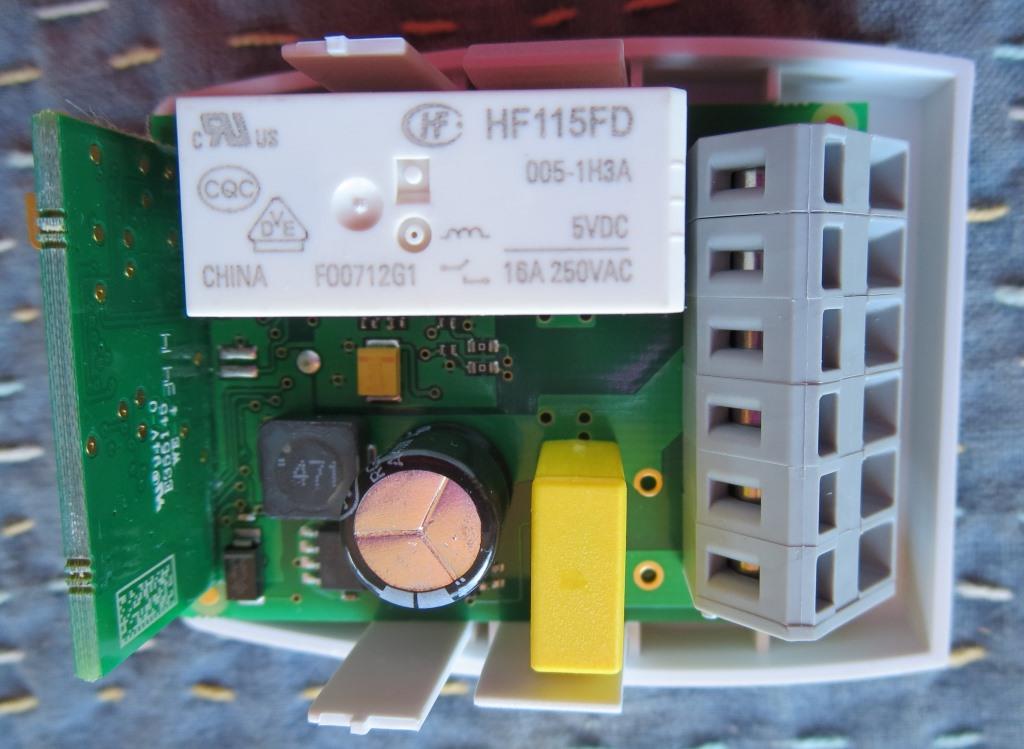

Plugwise Stealth hardware
Relay
Plugwise naked.JPG (104.22 KiB) Viewed 3400 times

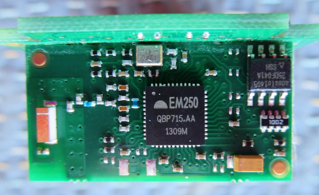

Open the box (not that I would do that, of course; instead I employed my X-Ray camera), and you would find a small PCB with a smaller daughterboard. This could be a 14-pin standard PICtail interface design in which case RC0 is expected to be the default output to timer1 clock through an opto-isolator (speculation on my part – it’s a custom daughterboard).

ZigBee and Flash
Plugwise Daughterboard.JPG (90.47 KiB) Viewed 3400 times
The main chip (Ember EM250) is a now-outdated ZigBee SOC. It has a 12MHz 16-bit processor core, 128k Flash, 5k RAM and a 128 AES engine in addition to the transceiver. Immediately adjacent is a 4 Meg serial firmware flash memory.

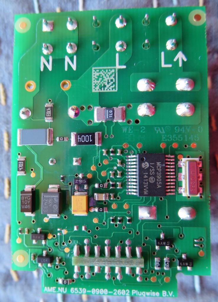

Main Board
Power metering chip
Plugwise bottom.JPG (120.11 KiB) Viewed 3400 times
The metering function is all on-chip, contained within a MCP3905A metering IC. This little bunny will measures ingle-phase active (real) power at 0.1% error and employs the IEC standard with very low shunt resistance (<200 microOhms) providing a proportional frequency output. The shunt appears to be a 1 millliOhm (0.001 Ohm) PMR25 resistor (marked 1L0 between live in and live out). These are rated as 1W.
The mains relay is a high-dielectric (5kV) 5V miniature relay with single pole single throw 16A connectors.

So – the relay contacts are obviously a vulnerable area, but if they were replaced or bridged, what is the maximum current that can a) be put through the shunt and b) be measured and transmitted safely? The shunt will be dissipating 1W at 37A AC RMS, so putting more than 30A through is obviously getting to be a concern (about 0.03V drop). Spec says 16A; I wonder if there is headroom in the frequency and/or parameter transfer for a higher current if the shunt will take it.
The 3905 reference design is specified for 10A with a 40A limit, using a shunt resistor of 250 microOhms (one quarter of the Plugwise implementation). If the current design doesn’t have a headroom for 32A measurement, one possibility (albeit a workaround) is a new shunt, an upgraded relay, a new device type in firmware, and use of a multiplier in the calculation software. I would be interested if anyone has got into the guts, as it were.

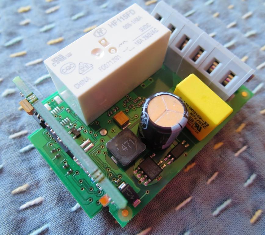

Stealth assembly
Plugwise top.JPG (90.19 KiB) Viewed 3400 times
