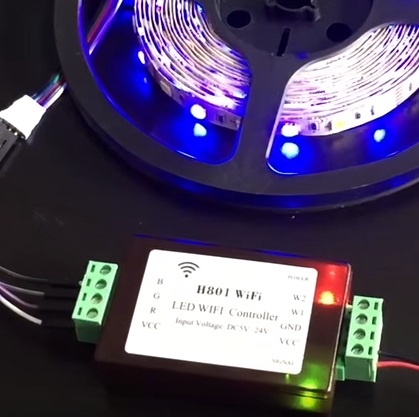

This post is about an upgrade to the popular H801 LED Strip Controller available for <10 eur from Aliexpress:
http://www.aliexpress.com/item/RGBWW-St ... ace2498d25
Together with Pieter (bwired) we did some modifications to the device and created a new firmware with the following features:
What has been added is:
1. Pre-Soldered USB-2-Serial adapter, to allow connection to the vThings Chrome Configuration App, to allow setting up Wifi, HTTP or MQTT connection
2. Ability to open an HTTP Web Server and allow controlling via HTTP Request
3. Ability to connect to an MQTT Server receive commands for LED Colors, and publish status updates
4. Ability for Over-The-Air update in case of new features or bugs
What has been removed:
- the original firmware that allows connection from an Android phone, opening a Wifi Hotspot and having some effects
If you are interested, in using this functionality you can:
- upgrade the module yourself: the firmware is open source and available freely here: https://github.com/vlast3k/vThingCO2 (i will put there some additional details on building ansd flashing later)
- send your device to me to upgrade it for you: price for the service is 10 eur and then 4-5 eur for shipping back
- or you can buy the device from me instead of aliexpress - in this case it costs 20 eur, and you get it within a week :) (but i have only 3-4 left and waiting for the new ones to arrive)
Re: Upgraded H801 Led Strip Controller from Aliexpress
This works perfectly at the moment.
With this controller you can connect 5 ledstrips or 1 rgb and 2 white.
Via http or mqtt you can control every ledstrip channel indipendly.
What is also a very nice feature is that you have a full status report via MQTT,
for example if you set the values via http or mqtt, after the values are set the status is broadcast back to the MQTT server.
So a cheap led controller with status is great! :)
Also asking for status can be done and it will broadcast the status every 2 mins.
We are still making small changes but it looks like this:
Ask for status of controller 1: client.publish('command/led/1', 'status');
status:
{"red":20,"green":1,"blue":2,"w1":30,"w2":10,"ver":"v1.11.1"}
set the desired values:
client.publish('command/led/4/Color', '20;1;2'); // set rgb (0 to 100%)
client.publish('command/led/4/W1', '30');
client.publish('command/led/4/W2', '10');
http command to set values:
http://10.0.0.123/?color=10;0;5&sw2=0&sw1=0
