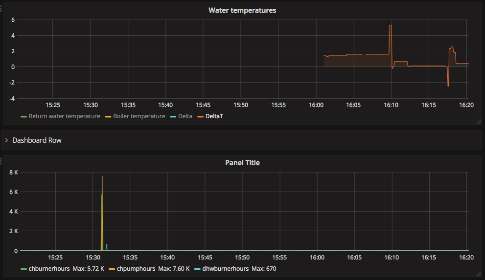

It seems to work as expected:
Screen Shot 2018-10-02 at 16.20.10.png (57.97 KiB) Viewed 12376 times
Thanks for the effort to create that PR @timoline!
