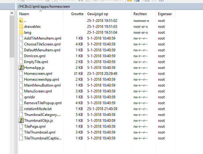

I have installed then package, but now I lost some tiles and it is impossible to change/add any tiles.
Does anyone has a suggestion?
Re: Toon app: rotating through tiles, automatically
Typically you can restore the old status by simply putting back your old homescreen app.Screamhouse wrote:I have installed then package, but now I lost some tiles and it is impossible to change/add any tiles.
But which firmware are you on? Did you unzip the homescreen app including subfolders for your firmware version?
Can you share a list with files in the .../apps/homescreen/ folder?

Firmware is 4.9.23
The folders are attached in the screenshot.
- 2018-01-26 16_24_48-homescreen - Eneco - WinSCP.png (36.8 KiB) Viewed 12287 times
This is the homescreen mod for firmware 4.11.6, that's why the zipfile is called "homescreen_mod_rotating_tiles_fw_4.11.6.zip".Screamhouse wrote:Firmware is 4.9.23
You should use the correct version for your firmware a few posts back: domoticaforum.eu/viewtopic.php?f=87& ... =15#p84007

N.B. The Homescreen mod version posted above for version 4.11.6 can also be used for firmware 4.10.6. The Homescreen app hasn't been updated in 4.11.6.
