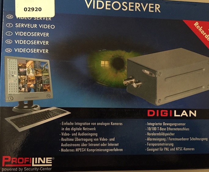

How can I discover the IP-adress from a Profiline Digilan videoserver
I have that Videoserver but no utility CD. Who can help me with these utilities?
Thanks, Verkenner
Best regards, Verkenner
Edwin2008
Posts: 721
Re: Utility CD for Profiline Digilan videoserver
Post by Edwin2008 »
If you know the Mac adres you could look up via arp - a or look in router at the dhcp leases
