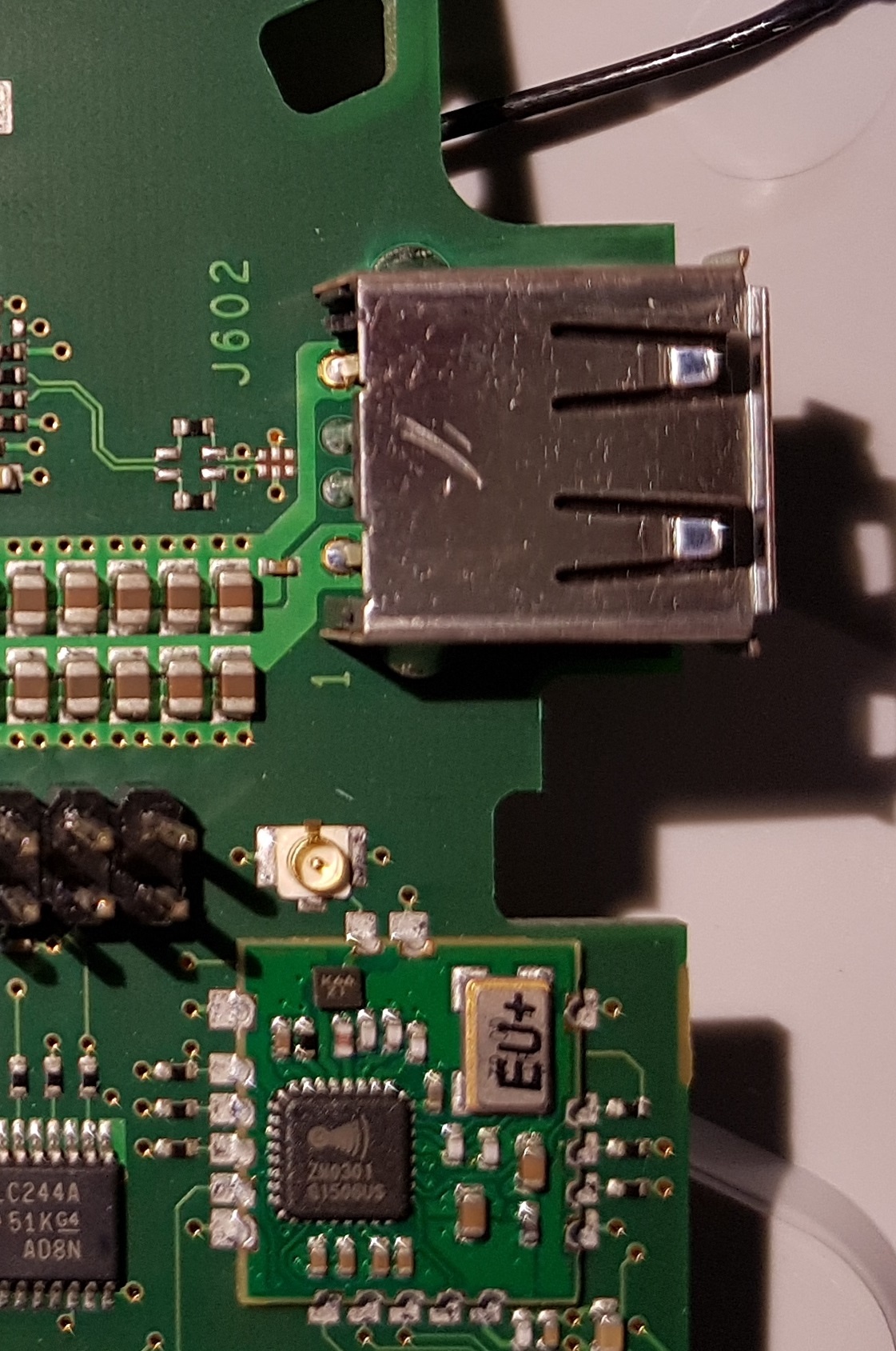

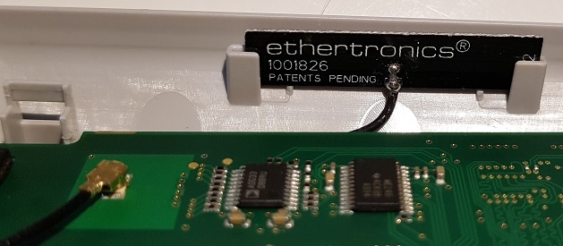

I found the solution to my issue.
After rooting my Toon, I connected to Zwave antenne on the wrong connector
this is the wrong connector
Beside the Zware chip is the connector for the Zwave antenne
