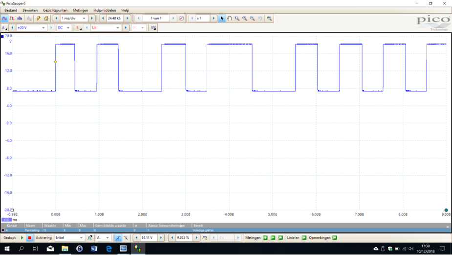

Instead i pulled out my scope and did some measurements. This is what i saw on the thermostat terminal:
This looks OK, doesn't it. But is to be expected since the thermostat side seems to work.
The boiler side is another story. The scope gave an overload when measuring on the boiler terminal (probe shield on GND) which would mean a voltage of over 20V. It didn't make any difference if both the OT-EMS and EMS-iRT or only the OT-EMS were connected. As expected, no real signal could be measured with nothing connected on the terminal.
With the EMS-OT connected, shouldn't a similar picture as on the thermostat side be expected?
