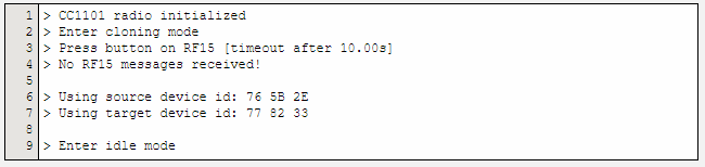

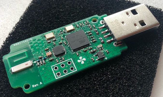

Atm I'm working on an usb dongle that is able to control my Orcon ventilation unit from my Home Assistant, so far, with help of what I can find online it works pretty ok. The usb dongle uses atmega32u4 running Arduino micro bootloader, for RF communication it uses CC1101:
When booting the usb dongle, it will be in pairing mode for 5sec, within the 5sec, you can press a button on the standard RF15 remote, the dongle will receive and copy the addresses.
Also controlling the FAN speed works very well. I would like to know if anyone can help me with requesting the current FAN speed from the ventilation unit? Which message do I need to send to request info without changing the FAN speed?
