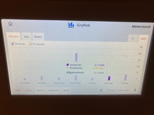

Post by gabokkers »
I use the solarPanel app successfully with my zeverSolar inverter. It's a great app!
I have one question though. The production numbers of my solarpanels are all zero if I show the numbers of the different days (see attached photo). On the day itself the production of the solarpanels are displayed correctly. Somehow it is not storing the daytotals at the end of the day. Any ideas how to solve this?
Toon grafiek stroom
Toon grafiek stroom

gabokkers wrote:I use the solarPanel app successfully with my zeverSolar inverter. It's a great app!
Have you updated the app to the latest version?
Yes, version 1.3.5 is installed.

gabokkers wrote:
I will check this weekend.
