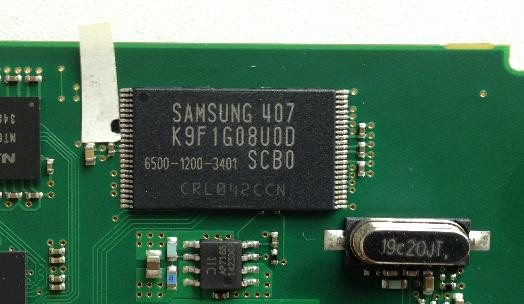

can someone please explain this:
Enter the u-boot menu by briefly shorting the proper control pins on
the NAND chip
Which chip is that? Can you please point it on a photo.

It's the samsung chip.
(there's only one of that brand on the pcb).
grtz,

Posts: 2035
al_n wrote:Which chip is that? Can you please point it on a photo.
I put a small piece of an adhesive label next to it and marked which pins to short to make the job easier.

wow, thanks @hvxl
These will be the 8th and 9th pins from top, right?

al_n wrote:wow, thanks @hvxl
I see pins 7, 8 & 9...
Yep, pin 1 is a the top left dot on the chip housing.
As long as you don't hit the pins in the middle (power supply), you should be OK.
good luck,

I guess at my age (44) those tiny pins are not ment to be messed with. I had to use a magnifying glass and put a tape on the pins to the left and to the right so I could hit pins 8 and 9 fast enough. This after trying like 30 times and getting twice a kernel panic. I was happy to get the U-Boot prompt eventually.
