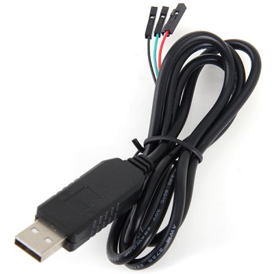

First: Thanks Marcel for youre support and help.. Finally found manual.
I gonna try root Toon with this:
https://www.aliexpress.com/item/1pcs-lo ... 0.0.KLsEJu
Hope that's work, but I think so. Is a Raspberry necessary, or is it possible with a desktop?
Re: Rooting Toon (or boxx)
I wouldn't, if I were you. It's a 5V device, whereas toon is a 3.3V logic level device. Try and find one with a 3.3V signal level, instead of the 5V of this one.
The tools you need depend on the bootloader version of your toon. Up to R8, a serial interface connected to a desktop computer (like this one, but with 3.3V signal level) will do. From R10 and possibly onwards, you will need JTAG hardware, which can be emulated with a raspi.
Posts: 1919
mAiden,
you will need this to connect your raspberry Pi (GPIO pins providing serial port) to Toon for rooting (just need 3 wires).
Raspberries serial port is already 3.3V.
https://ae01.alicdn.com/kf/HTB1cCMjJVXX ... 40x640.jpg

Post by Nielsch »
Sorry, didn't notice :oops:
Some time ago I bought this: https://nl.aliexpress.com/item/1pcs-CP2 ... 0.0.kXk4zF
Can I use this to root my Toon, or is it a risk to try it?
I connected it to a USB port and measured 3.3V on TXD and RXD with a multimeter.
In that case, it should work, if your OS supports it.
