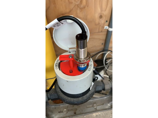

Received all the parts and installed everything. Really easy install
. I downloaded a bracket from the thingiverse website for the sensus 620 and 3d printed it. Fits perfect!
Keep up the good work!
