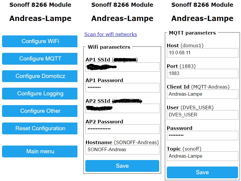

Hi All,
This is my first post on this forum. I have been reading the whole thread, and I think that my problem is related to the above quote, but I'm at and end where I cannot find the solution my self.
I have been playing with the MQTT plugin, and everything seems to be working. But I have one issue that I cannot figure out (Maybe its more a HS problem than related to the Plugin. :roll: )
The setup:
HS3 PRO on Windows 10
Broker running on the same PC
Test device: ESP8266 (Sonoff reprogrammed to MQTT)
The problem:
A: I cannot assign On/Off buttons in the HS device list to this device. I have added them in the Status Graphics under the device but they do now show up. So I cannot control the device from Device management list. (2 status [On/Off] and 2 control lines [On/Off])
B: Then I tried to make a manual device and Publish it to the following Topic: "stat/Andreas-Lampe/POWER" I have checked the String and/or Value in the left colums, this is sending values to the broker, but I need "On" or "Off" but it's sending 100 or 0.
C: I then made an event that send "On" when device changes on(100), and send "Off" when device changes off(0) - This works, but I'll ikke to avoid to have to get extra devices and scrits for each MQTT device I have to control.
I hope this makes sense to you guys, let me know if you need more information in order to help me along.
/Steffen

Daigaard
Posts: 3
Joined: Sun Jan 15, 2017 11:31 am
Re: HS3 MQTT Plugin
Post by Daigaard »
raymonvdm wrote:Did you use espeasy on the sonoff?
I have a nodemcu running espeasy. I will try tot replicatie tour setup.
I have used this project for my Sonoff and it does not seem that I can change the On / Off command to a 1 /0 values. See attached picture.
https://github.com/arendst/Sonoff-MQTT-OTA
Please provide any advice on how to proceed, is there no way to have Homeseer change the value being send?
Sonoff configuration options.
Forum Sonoff.jpg (145.41 KiB) Viewed 14030 times
