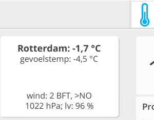

During testing I also found an enormous bug: on the tile the weather icon of the next weather station was shown, not the selected weather station.
Changelog:
- bugfix icon weather station on tile
- replace "https" by "http" in the xml data feed, all icons in the 5-day forecast are now ok as well

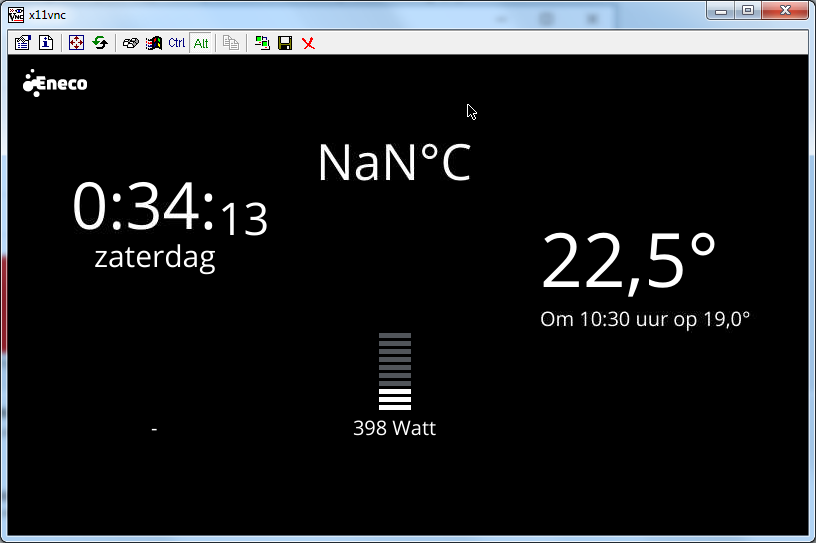

Edit:
For just a short moment I had the NaN (Not a Number) shown.
At the same time the Eneco app showed a dash (-) (and didn't get updated much longer).

I noticed as well that around midnight they somehow reset the xml.buienradar.file. For a very short period it doesn't contain any weatherstation data at all. That's why the temperature shows NaN. Should resolve itself shortly after midnight (within 10 mins)
