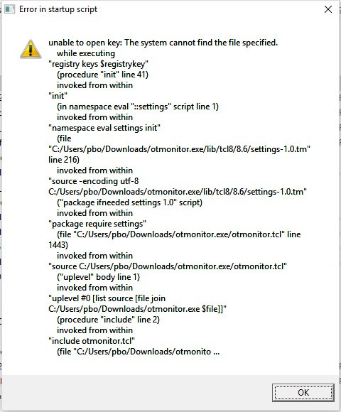

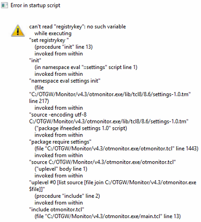

Hi Schelte,
how to use v4.3 on Windows?
Do I need to configure something prior to run v4.3?
Many thanks in advance.
Opentherm Monitor v.4.3 error
Stingone
Posts: 8
Joined: Sun Nov 01, 2015 1:49 am
Re: Opentherm Monitor - Custom web pages
Post by Stingone »
Same error here on 3 laptops :(
Posts: 2031
Apparently I still had some half-finished code left in there. Please let me know whether 4.3.0.1 fixes the problem.
