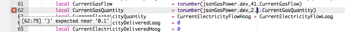

Screen Shot 2018-11-04 at 22.16.18.png (46.95 KiB) Viewed 14038 times
When i enter a number like dev_2.1 it gives an error right after putting it in, complaining about " expected ')' near '0.1' "
Guess this is something I need to work on tomorrow. Now it's time for other fun things
