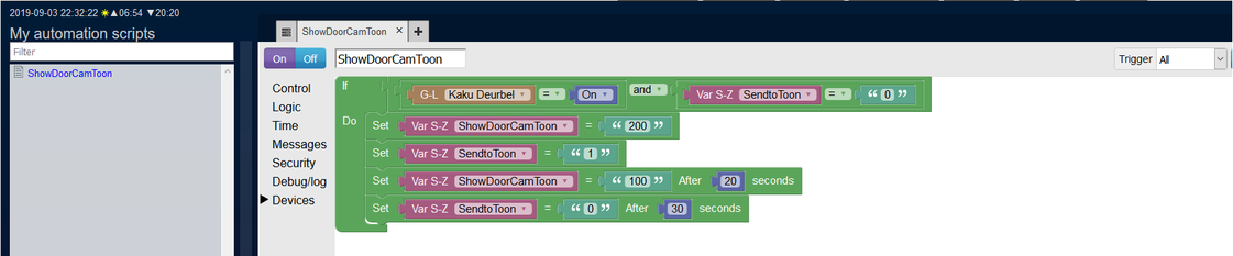

- showdoorcamtoon-script-as-bloc.png (82.79 KiB) Viewed 10001 times

Now rebuild the "if-do statement" like in the screenshot on page 1 of this thread.
UPDATE 17-12-2019: You can also use a dzVents script instead of Blockly:
return
on =
devices =
'Deurbel',
logging =
level = domoticz.LOG_DEBUG,
marker = 'Deurbel',
execute = function(dz, item)
if item.active then
dz.log('Device ' .. item.name .. ' was pushed', dz.LOG_DEBUG)
local sendToToon = dz.variables('SendtoToon')
local showDoorCamToon = dz.variables('ShowDoorCamToon')
if sendToToon.value == '0' then
showDoorCamToon.set('200')
showDoorCamToon.set('100').afterSec(30)
sendToToon.set('1')
sendToToon.set('0').afterSec(30)
end
end
end
