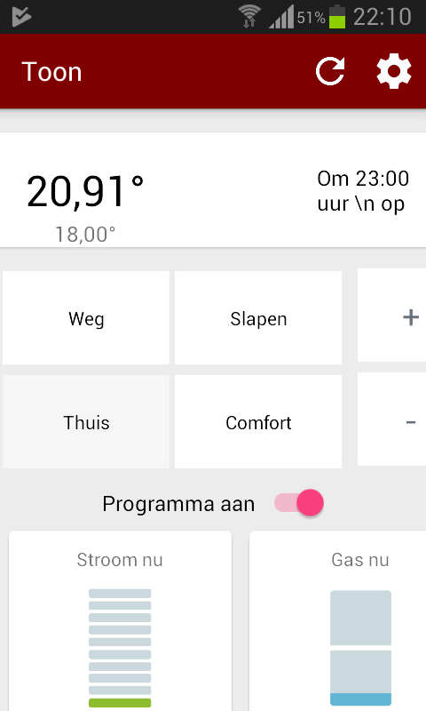

Just installed your app on my ancient Samsung Galaxy S3 mini. Screen resolution barely non-negative ;-).
Apart from my compliments for this functioning app, just a few remarks:
The screen doesn't fit my phone, see attached screenshot. It could be the age of my phone, or the fact that my toon is a toon2? Toon screen resolution 1024*600 or thereabouts?
There's a linefeed "\n" in view in the program step window "Om 23:00 uur \n op..."
As soon as I want to adjust temp I get the message "Fout bij het ophalen van temperatuurgegevens: response data or responseHandler is null". That could also be because of my toon being on my desk and not connected to a boiler. Will attach it to my boiler emulator later this week.

S3 Mini is too old for these days.... So, yes, it's because of the age of your phone.
The newline issue is fixed in the next release. And we're working on the responseHandler error.

No, we fetch the data and set that in our own UI.
I knew this was an problem however I don't have an solution as of yet and, since most of the devices won't be having this issue, It'll be not very high on the (now very long) to-do list, I'm sorry.
marcelr wrote:As soon as I want to adjust temp I get the message "Fout bij het ophalen van temperatuurgegevens: response data or responseHandler is null". That could also be because of my toon being on my desk and not connected to a boiler. Will attach it to my boiler emulator later this week.
Nope, that's not because of your boiler but an error in the app.
But since like an hour, I too have an rooted Toon (Thanks to WickedMaster!) so I'll be able to try and resolve these issues.

https://github.com/fabianblom/Toon-Android/issues/24
Much better in 0.5.4
marcelr wrote:There's a linefeed "\n" in view in the program step window "Om 23:00 uur \n op..."
Fixed in 0.5.4
Fixed in 0.5.4
