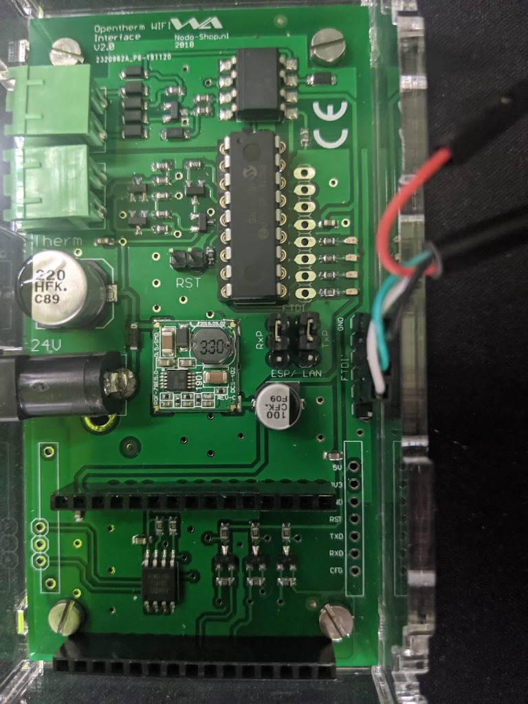

How do I check the 5V? Can I simple use the 5V and GND connections?
Posts: 2033
Re: Strange behaviour of otgw
So it looks like the PIC and opto-coupler are not heating up to alarming levels. But I was actually thinking the power circuitry may be getting hot. I believe the Nodo shop has done different types of power converters. I don't know which one you have.
My intention was indeed for you to measure between any GND and 5V connections you can reach. Measure both DC and AC. With a good multimeter, you should get a stable 5V when measuring DC, and 0V on AC. Cheap multimeters may also show 5V on AC. Using an oscilloscope would be even better, but somehow that's not part of everyone's toolbox.

None of the components are getting warmer than about 28°C at maximum.
Before and after failure is 5V DC actually 4.98V and AC < 0.01V. Sounds pretty much okay to me.
Sorry, no oscilloscope in my toolbox.
Posts: 2033
Agreed, that looks fine. Then the next thing to try would be a different PIC.

I've got a new PIC from Nodo. So I replaced the old PIC and tried to upload the firmware.
After hitting the "Program" button, the status bar says "Switching gateway to self-programming mode", and after a few seconds it says "Please manually reset the OpenTherm Gateway".
But how do I reset it?
should I shortcut the RST pins?
Posts: 2033
Doesn't the PIC already contain the firmware? It needs to have at least the bootloader. But then just briefly shorting the reset pins when otmonitor asks for a reset should work.
