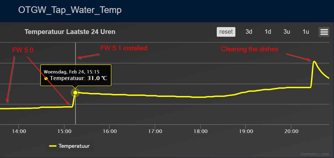

I can confirm the values in the PS=1 report for the 'DWH Temperature', MsgID=26, now show the same values as in otmonitor.
2021-02-24 20_50_07-Domoticz - DWH Temperature.png (95.04 KiB) Viewed 7526 times
FW upgrade ran smoothly, no problems.
