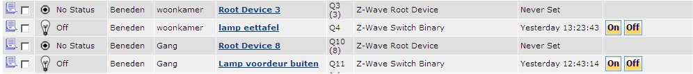

I have only one problem with the Merten push button 2-gang:
In homeseer both gangs are there, but only with 1 gang I can work. The 2de gang has no status. See image.
How can I change that?

I have done an update from HSpro 2.4 to 2.5 and the problems with the 2-gang push button are disappeared.
Both buttons from the Merten 506219 are now seen in the staus of HS and also be used.
Marvellous for the users of this switch. Has other people the same experients?
See also http://www.domoticaforum.eu/viewtopic.p ... 190#p47851
Because it is very important to do what Enver told me about recanning the zwave devices.
B.R. Wim :) :wink:
