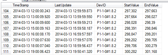

Bringing up this topic as I have been working on a historical database for my energy reading. I'm using Homeseer 3 to load the changed values to a database table in SQL Server and used the approach outlined in this topic. I have for each hour a record, starting at the beginning of the hour and updating until the next hour starts. This works well and I can find all readings in the database. I'm storing at the moment just the smart meter readings every 10s when the reading comes in. I'm planning in optimising this when everything is working well.
The issue I see is that I'm missing data when the hour changes. I liked to idea to have the start and end value for every hour, but when changing to the next hour I loose one interval. I can solve this by calculating the difference between the end valvues, but then loose the advantage of the start and end value every hour.
How have others solved this? What am I missing?

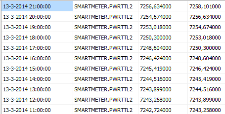

This is the end result in my MS SQL Server:

Doing things this way is a bit of a trade-off, it's not necessary to store both values, that's correct.
But for example, a simple query result is instantly column chart ready.
And in fact it's not really redundant - that's when data is repeated in 2 or more tables (like copying a customers' VAT number to the sales order table) which is not the case here. In this case, they do have a different meaning. :wink:

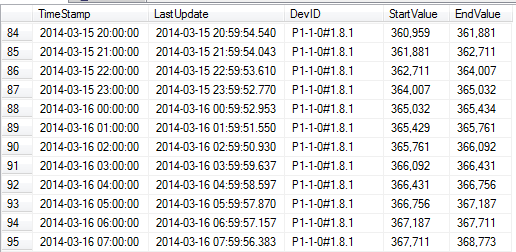

The data looks like this when everything is working well.
