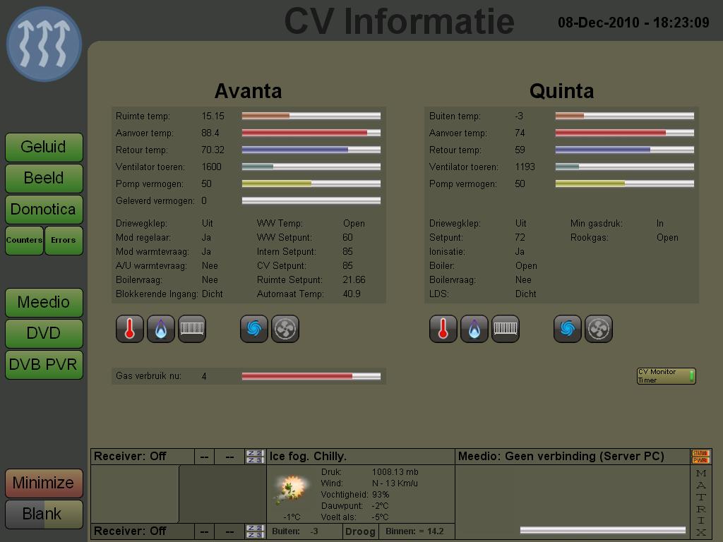

I got the package last monday evening and hooked it up to my 4 wire cable running to my PC and it worked right away with the Recom software. Just like the Avanta interface I had to connect pins 2, 3, 4 and 5 of the standard db9 serial connector. Pin 4 goes to pins 1 and 6 (null modem). Connecting it to HouseBot took sometime to figure out because HouseBot doesn't have the 4800 Baud option as standard but luckily you can manually type it in. So the Quinta runs on 4800 Baud. Rest is the same as the Avanta.
The protocol is really old and not robust at all. Unlike the Avanta, the Quinta doesn't have a start and stop byte, no length byte, a checksum byte I didn't figure out yet and two command bytes which appear in some cases, but not in others.
The RPM bytes took a long time to figure out, but after some trial and error, the formule is: 7.500.000 / received value = RPM. I got all monitoring data and errors visualised in HouseBot now and it looks really nice in combination with my Avanta setup.
I opened up the interface and it has lots of stuff in it. By taking a short look, it connects about 4 pins of the 14 pin header and it uses a MAX202 smd interface chip. For more info on the interface I need to open it up again and do some research.
Attached an image of what my HouseBot panel looks like. Errors and counters are displayed on separate panels not show here.

Hi Richard, looks really good!! I like the way you have set it up side by side.
